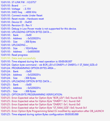

As you are able to connect to the device and to flash it , I propose this stage to unzip the attached file that contains a working option bytes. Try to upload them to your device. Please read this article on how to do it: Restoring the STM32 option bytes to their factory settings using STM32CubeProgrammer / section: 1.2 Option bytes factory reset (import option)
Thank you @mƎALLEm. I tried what you have suggested, CubeProgrammer has come back with the following error.
As per the article used, 'Under Reset' Mode with 'Hardware Reset' to perform this operation.

I think, and unfortunately for you, the flash is corrupted and couldn't be recovered. I suggest to replace the device.
