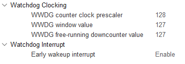

I am using STM32H723 and have implemented WWDG. Below is my configuration:
Are there possibility that when the system resets due to watchdog it would not trigger its ISR.

Not sure, never used WWDG, but why not
NVIC_DisableIRQ(WWDG_IRQn);
2025-09-25 6:21 AM
The EWI interrupt will function as intended.
There exist scenarios in which it will not be called. For example, if interrupts are disabled, it won't be called.
2025-09-25 11:03 PM
@TDK I am not disabling its interrupts. Even if I disable the interrupt it will still reset but without triggering its ISR
2025-09-26 4:10 AM
Isn't that what you asked for? Scratch head...
2025-09-26 6:04 AM
Show your code.
