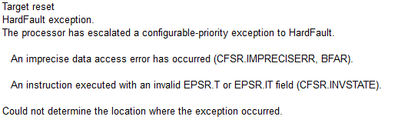

Some info about my setup, as mentioned earlier, it's a custom board with BOOT0 and RESET pins exposed using a switch, and there is a JTAG interface for debugging purposes, along with a SEGGER JLink. The way I managed to brick is that I accidentally pulled the RESET line while flashing a FW using Jlink, and since then, it seems memory is in locked mode, and neither Jlink nor ST-vLink is helpful in the rescue mission.
Things I have already tried and did not work... maybe I am missing something.
  1. I have been in this situation before, and was able to recover from it using JLInk STM32 Unlock tool, but surprisingly, this time, that too is unable to reset the Option Bytes and fails to recover.
  2. Tried using the JLink Commander tool too, which was also not able to erase the memory, returned error code -5.
  3. Tried to use STM32CubeProgrammer with Jlink, and tried to gain control of the MCU in reset mode, and tried to mass erase and reset option bytes, but it did not work.
  4. Tried to use STM32CubeProgrammer with Jlink, and tried to gain control of the MCU in reset mode using DFU by pulling BOOT0, then RESET and releasing RESET while still holding BOOT0 high and later releasing it, but that too failed to mass erase and reset option bytes.
  5. Steps 3 and 4 were also repeated using ST-vLink, but failed in the same manner.

Ok try with:
Mode: Power down mode
Reset mode: Hardware reset
@mƎALLEm yes that did work...
  1. Set up CubeProgrammer with the suggested config.
  2. Did 'Full Chip Erase', which was successful
  3. Used SEGGER JLink to cross-check if it worked, and it seems to have worked.
What should be my next step? Do you think I should try flashing a working/known FW file and see if that boots the MCU?

@mƎALLEm yes, the flash content was all 0xFFFF.
But I think the system is still bricked.
PS: This is using IAR & JLink. I could not flash.
