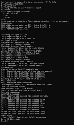

UPDATE: Just connected SEGGER JLink and connected normally, even though ST-vLink said it was successful erasing memory, JLink data read back shows ST-vLink was not successful.
JLink Commander Output if it helps...
