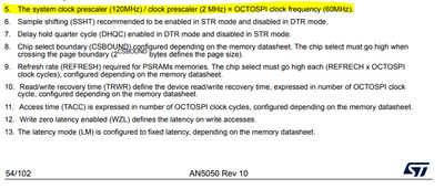

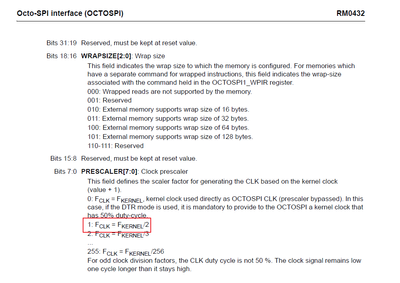

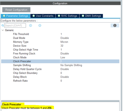

> I am on vacation and will reply to you within next week, but according to picture below, isn't the clock on the bus 60M?
The Reference manual detailed the "Bits 7:0 PRESCALER[7:0]: Clock prescaler". This field must be between 0 and 255 and defines the scaler factor for generating the CLK based on the kernel clock (value + 1).
In STM32CubeMX, the Clock Prescaler must be between 1 and 256. In this case the Clock Prescaler = (PRESCALER[7:0]: Clock prescaler)+ 1

Zhou JianQiang

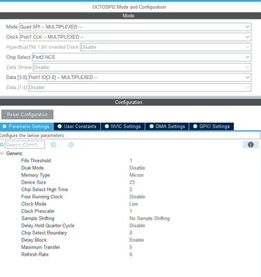

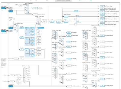

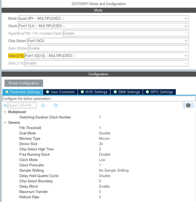

>Which frequency are you use for OCTOSPI?
-->60M, you can refer pictures below for details, OCTOSPI1 for Nor flash W25Q128, OCTOSPI2 for PASRAM APS6404L
>Could you please check the OCTOSPI configuration and precisely Chip select boundary (CSBOUND). Please refer to AN5050 and precisely Table 8. STM32CubeMX - Configuration of OCTOSPI parameters, may help you for checking OCTOSPI configuration.
-->I use OCTOSPI multiplexed mode as above, so I think it is different from the AN5050

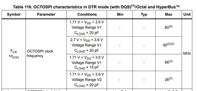

--> Clock Prescaler: You set the prescaler to 1 in STM32CubeMx,. This means the clock on the bus is 120MHz / 1 = 120MHz. This behavior is detail in AN5050 and in this FAQ How to set up the OSPI peripheral to interface with the IS25LX256 from ISSI
Please refer to STM32L4P5 datasheet and check the maximum OCTOSPI frequency.
Please try to decrease the OCTOSPI frequency and let me know if the issue is solved or not?
Sample shifting (SSHT) should be enabled in STR mode and disabled in DTR mode. Delay hold quarter cycle (DHQC) should be enabled in DTR mode and disabled in STR mode.
Chip select boundary (CSBOUND) is configured depending on the memory datasheet and required for RAM memory. The chip select must go high when crossing the page boundary (2CSBOUND bytes defines the page size). In the PSRAM the page size is equal to 1024. So, CSBOUND=10.

-->I am on vacation and will reply to you within next week, but according to picture below, isn't the clock on the bus 60M?

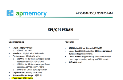

-->I will modify as your suggestion.

Hi @KDJEM.1 :
Thank you for your help.
After I set Clock Prescaler from 1 to 2 in Cubemx and CSBOUND to 10, I tested it for 8 hours continuously, it works correctly, so I think this problem should be fixed.

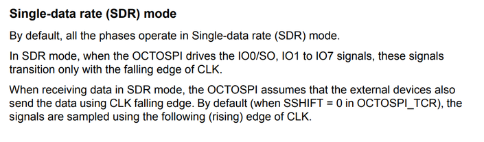

3. According to reference manual, it seems that Sample shifting (SSHT) can be disabled in STR mode, is it correct?
--> Yes, in SDR mode and when SSHIFT = 0 in OCTOSPI_TCR by default  the signals are sampled using the following (rising) edge of CLK as mentioned in reference manual.
So, the SSHIFT can be enabled when reading from the memory in SDR mode but must not be used in DTR mode. When enabled, the sampling is delayed by one more 1/2 OCTOSPI/HSPI/XSPI clock cycle enabling more relaxed input timings.
