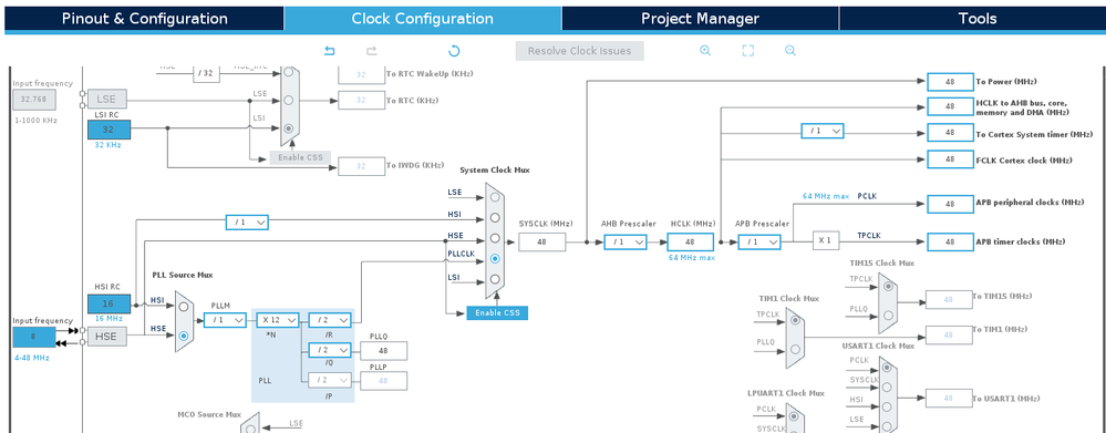

I believe that my problem has to do with the main clock. I have configured my clocks to be the following(USB is set to use PLLQ, not HSI48):
Even though the PLLQ is set to 48MHZ the setup does not finish correctly. Could this be due to the relatively slow clock(8MHZ)? If so, is there a better frequency to use for the external oscillator in order to provide good USB communication?

1. What's not finished correctly on setup?
2. Your USB works fine with one com channel, so why you think it has to do with the clock and not your program is the problem?
Because if it is plugged into my computer it will not work. If I leave it plugged in but then connect it to my VMWare virtual machine, it enumerates properly. I believe this is because VMWare effectively has a virtual USB hub that is more tolerant of the timings.

If I use the HSI48 I can't enumerate the device in this configuration.
