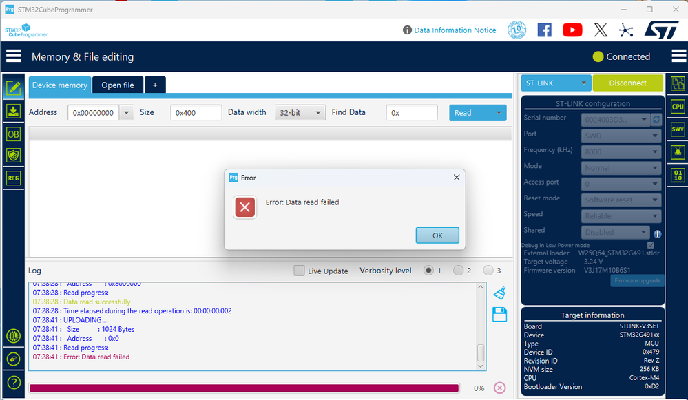

I need to use an external loader via single SPI for a project. Despite performing all the necessary steps. I'm getting an error through CubeProgrammmer.

I can't read and write to start address. As you see at image, I have an error. Loader was selected by the way.

In addition, I tried Read() function above. This function at above only return 1 so, There shouldn't be any errors. But I'm still getting errors.
I need to write an external loader for my processor. I've tried many things but haven't succeeded. I would appreciate your help.

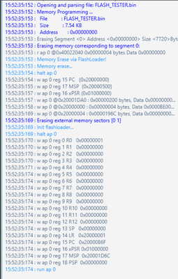

I built the code using the IAR Embedded Workbench for generating .stldr file. Added the following lines to Init() function at top:
char* startadd = __section_begin(".bss");
uint32_t size = __section_size(".bss");
memset(startadd,0,size);
Now I can read starter address but, I cannot write any data on the address. When start the write section, I have not a error.
As you can see, External loader can go Init() function but I cannot write at starter address.
