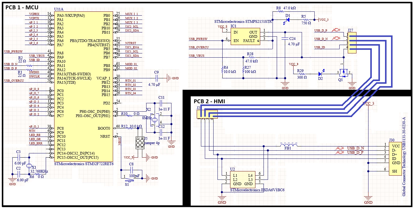

With the help of various links and documents I have tried to produce a schematic:
- https://community.st.com/t5/stm32-mcus-products/problem-with-usb-otg-in-host-mode-no-host-user-class-active/td-p/572407
- https://community.st.com/t5/stm32-mcus-products/problem-with-usb-otg-fs-device/td-p/622824
- NUCLEO-144pins_Altium_Schematics-Layout : MB1137.pdf : page 4
- https://controllerstech.com/usb-cdc-device-and-host-in-stm32/
- AN4869 Rev6
The basis comes from AN4869 page 16:
My schematic (2 PCBs linked by a small MOLEX type cable in blue):
In general I would like to know if this schematic is functional and correct.
More precisely:
- C24 = 4.7uF but it says "MAX". Is it more appropriate to use 1uF?
- Certain example adds a 1.5k ohms resistor on DP, is this necessary?
- Is R8 = 47k ohms useful, given that there's already "- VCC3->R5->D1 -"?
- For the "EN" input of the STMPS2151STR there's a pull-down R4 = 10k ohms but on some examples it's a pull-up, what's the right solution?
- Are the 2 resistors R1, R2 = 22 ohms essential for impedance matching?
- Is the FB1 ferrite really necessary, and won't it interfere with the VBUS?

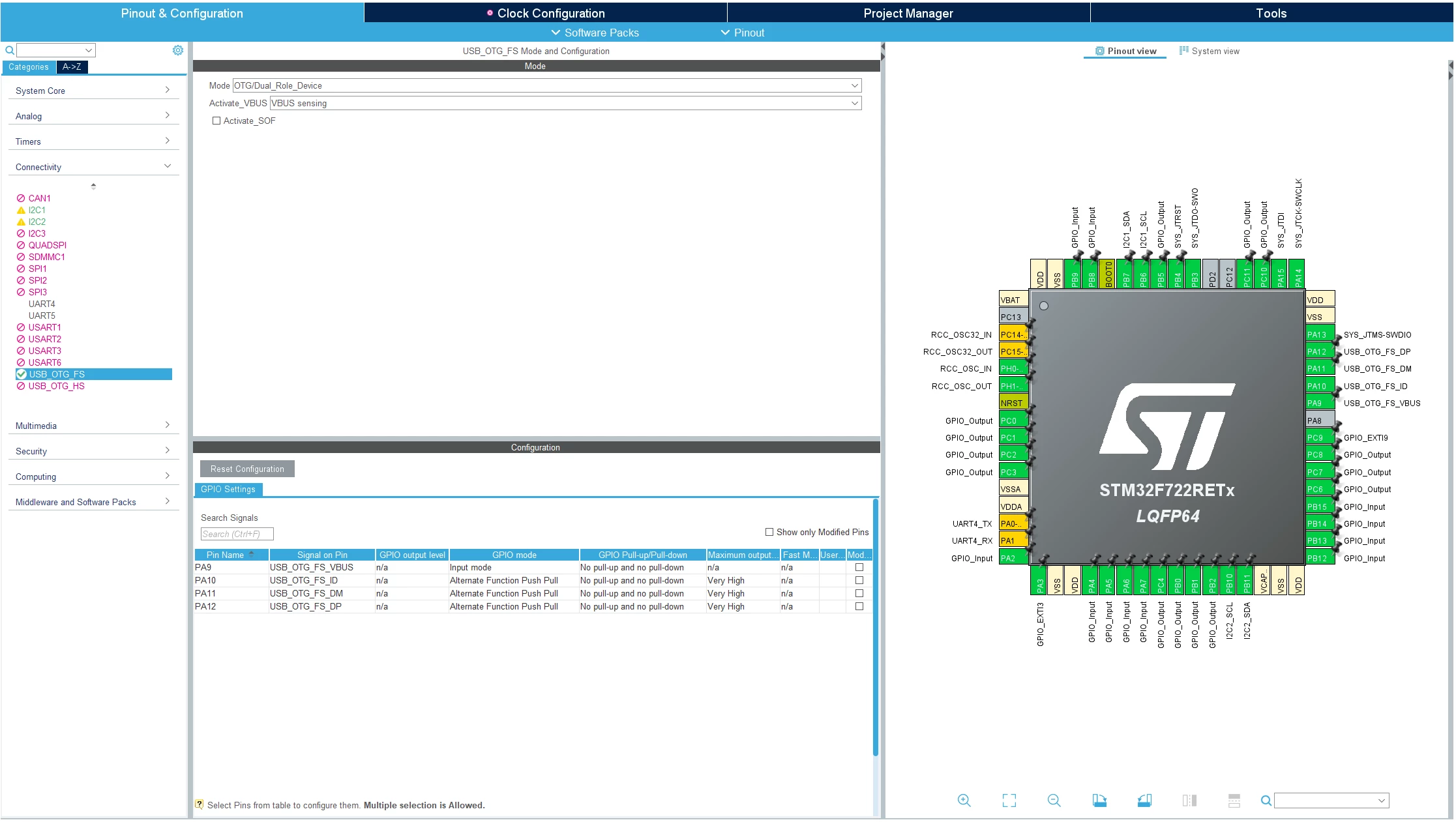

- Apart from enabling USB OTG in STM32CubeIDE, is there any special configuration required for USB_OTG_VBUS?

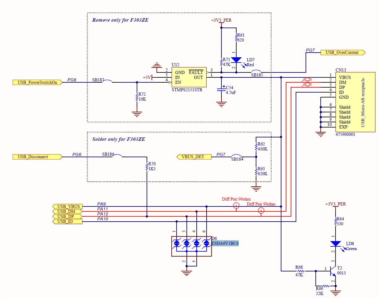

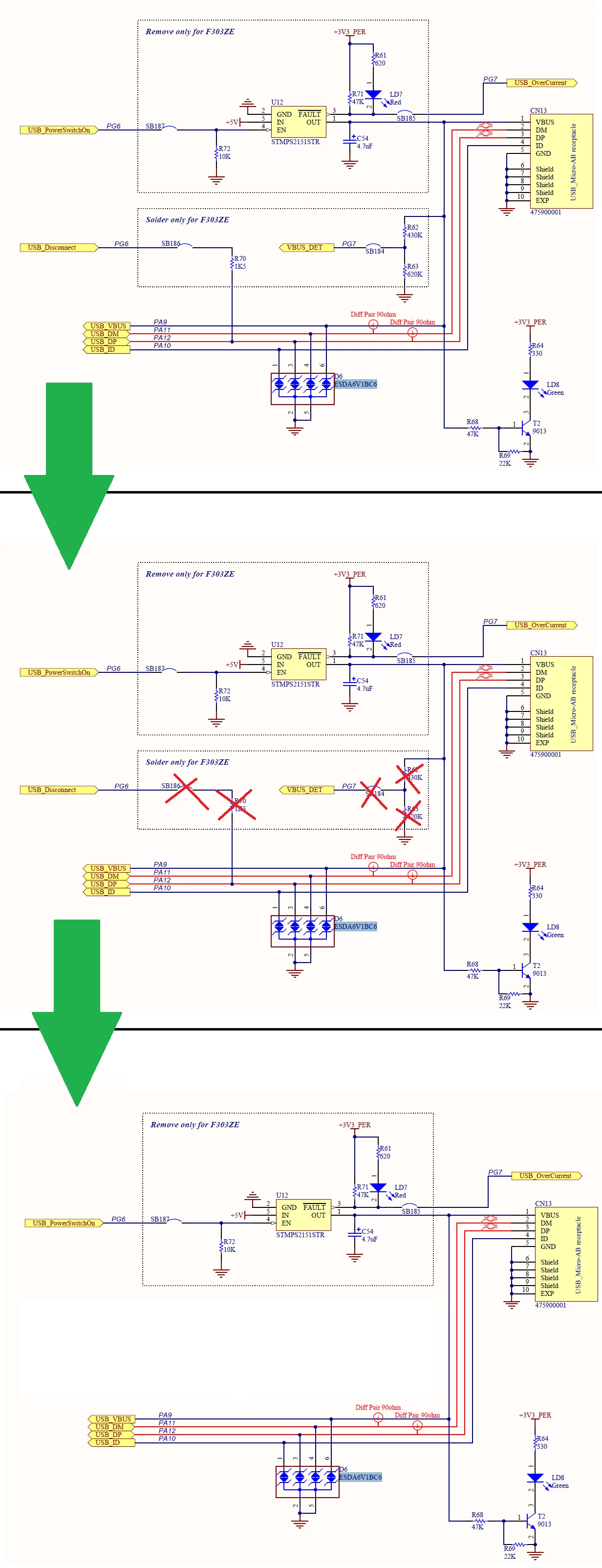

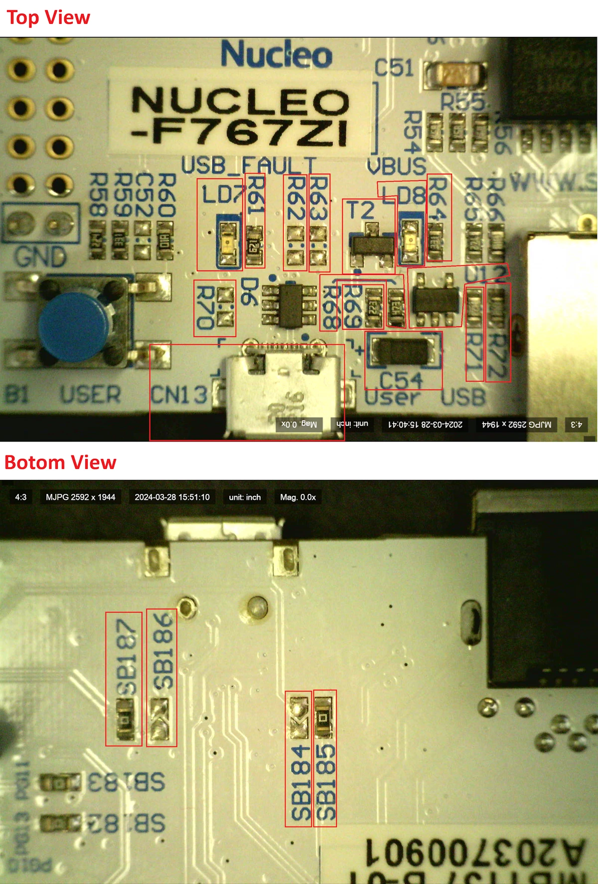

Finally, in order to obtain the most accurate diagram possible, I found a solution.
I have a NUCLEO-F767ZI board with which I've set up a USB OTG connection that works. Since I have the physical board and the electronic schematics, I did a bit of retro engineering.
Schematic:
Circuit:
On the board you can see that some components are not mounted:
- R70
- R62
- R63
- SB186
- SB 184
And so I can deduce the final schematic:
I just need to find 4 special components:
- C54
- T2 9013
- D6 ESDA6V1BC6
- U12 STMPS2151STR
After some research I think that should do the trick:
https://ch.farnell.com/fr-CH/vishay/tmcua1c475ktrf/condensateur-4-7-f-16v-10/dp/2491452
https://ch.farnell.com/fr-CH/on-semiconductor/bc818-40lt1g/transistor-bipol-npn-25v-sot-23/dp/2464038
https://ch.farnell.com/fr-CH/stmicroelectronics/esda6v1bc6/diode-protection-esd-5v-sot-23/dp/2353644?st=esda6v1bc6
https://ch.farnell.com/fr-CH/stmicroelectronics/stmps2151str/power-switch-1ch-500ma-sot23-5/dp/1842616?st=STMPS2151STR
I'll make the modifications and give it a try.

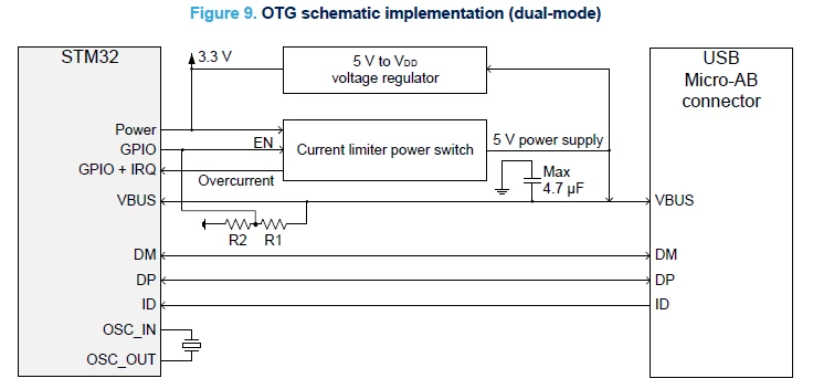

That's my problem, in my opinion the 2 documents you gave me are contradictory.
In "Application note" chapter 3.3 page 16 there is this concept diagram:
The VBUS line is directly linked to the MCU.
But in the "Harware development" document, chapter 1.1.2 page 7:
It is specified that the voltage must not exceed 3.6 V, which does not allow a direct link with the VBUS.
How can I do just that?

VDDUSB is different from VBUS. VDDUSB=3.3V allows supplying USB transceiver: PHY FS in your case.
When HNP or SRP is enabled the VBUS sensing pin should be connected to VBUS.
Vbus is only present in between active sessions in SRP protocol. See here to learn how to manage it.

Technical Moderator
March 26, 2024
Hi again @Boris19
Please note that I cannot check your PCB. However, I can give you just recommendations and guidelines.
It seems the PCB is not yet correct. Here are some points to consider:
USB Disco pin cannot be connected to USB_DP signal.
Why do you use USB_VBUS_DET? You are missing 0 Ohm resistor on USB_PWRSW pin for the pull down.
Check Q1 transistor implementation on the reference board.
> In my case, the MCU which is the peripheral is self-powered and therefore meets this condition.
OTG dual role should allow to switch power delivery through the power switch.
Also Caution ESDA6V1BC6 (D5) is not entirely securing USB pins against ESD.
I hope this helps!

1. USB Disco pin cannot be connected to USB_DP signal.
However, this is what is described in your diagram with a 1.5kohm resistor.
Your example:
My idea:
2. Why do you use USB_VBUS_DET?
That's where it's not clear. The ST documentation doesn't mention VBUS_DETECTION, but there is a link between the VBUS and a GPIO input via a bridge divider. For me, this represents VBUS_DETECTION.
VBUS in green and VBUS_DETECTION in blue:
It's also present in your example diagram (in green):
