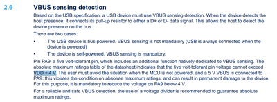

From a USB specification, a USB device should use VBUS sensing detection:
When a host connection is detected by the device, the device connects the pull-up resistor either to D+ or to the D- data signal. This allows the host to detect device presence on the bus.
There are two use cases:
  • If the USB device is bus-poweredVBUS sensing is NOT mandatory: USB is connected all the time when the device is powered
  • If the USB device is self-poweredVBUS sensing is mandatory
On STM32F2/F4/F7/L4, peripheral USB OTG_FS (OTG_HS without external PHY) is natively dedicated for VBUS sensing with pin PA9 (PB13 for HS), which is a +5 V tolerant pin.

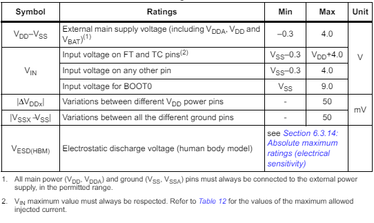

In the datasheet DS10314 section 6.2, table 11, the "Absolute maximum rating" (AMR) table states that a +5 V tolerant pin voltage can be maximally VDD+4 V. So, the situation where the MCU is not powered and 5 V VBUS is connected to PA9 must be avoided because it is violating AMR.

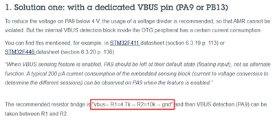

1. Solution one: with a dedicated VBUS pin (PA9 or PB13)
To reduce the voltage on PA9 below 4 V, the usage of a voltage divider is recommended, so that AMR cannot be violated. But the internal VBUS detection block inside the OTG peripheral has a certain current consumption.
You can find this mentioned, for example, in STM32F411 datasheet (section 6.3.19 p. 113) or STM32F446 datasheet (section 6.3.20 p. 136):
“When VBUS sensing feature is enabled, PA9 should be left at their default state (floating input), not as alternate function. A typical 200 µA current consumption of the embedded sensing block (current to voltage conversion to determine the different sessions) can be observed on PA9 when the feature is enabled.”
The recommended resistor bridge is "vbus-- R1=4.7k -- R2=10k -- gnd" and then VBUS detection (PA9) can be taken between R1 and R2.

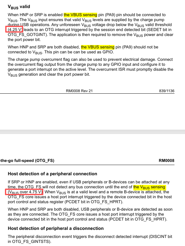

It is clearly stated here that the VBUS threshold is 4.25V. If you use a resistive voltage divider, it will not work properly. One requires a voltage greater than 4.25V, while the other requires a voltage less than 4V. This is a design bug.

4.25~4.75V?The official response should be that it cannot be achieved, as the voltage division is not met.

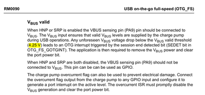

VBus valid
When HNP or SRP is enabled the VBUS sensing pin (PA9) pin should be connected toVBus. The VBus input ensures that valid VBus levels are supplied by the charge pumpduring USB operations. Any unforeseen VBus voltage drop below the VBus valid threshold4.25 V) leads to an OTG interrupt triggered by the session end detected bit (SEDET bit inOTG_FS_GOTGINT). The application is then required to remove the VBus power and clearthe port power bit.
When HNP and SRP are both disabled, the VBUS sensing pin (PA9) should not beconnected to VBus. This pin can be can be used as GPIO.The charge pump overcurrent flag can also be used to prevent electrical damage. Connectthe overcurrent flag output from the charge pump to any GPIO input and configure it togenerate a port interrupt on the active level. The overcurrent ISR must promptly disable theVgus generation and clear the port power bit.
