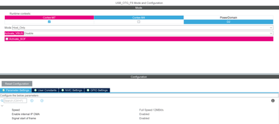

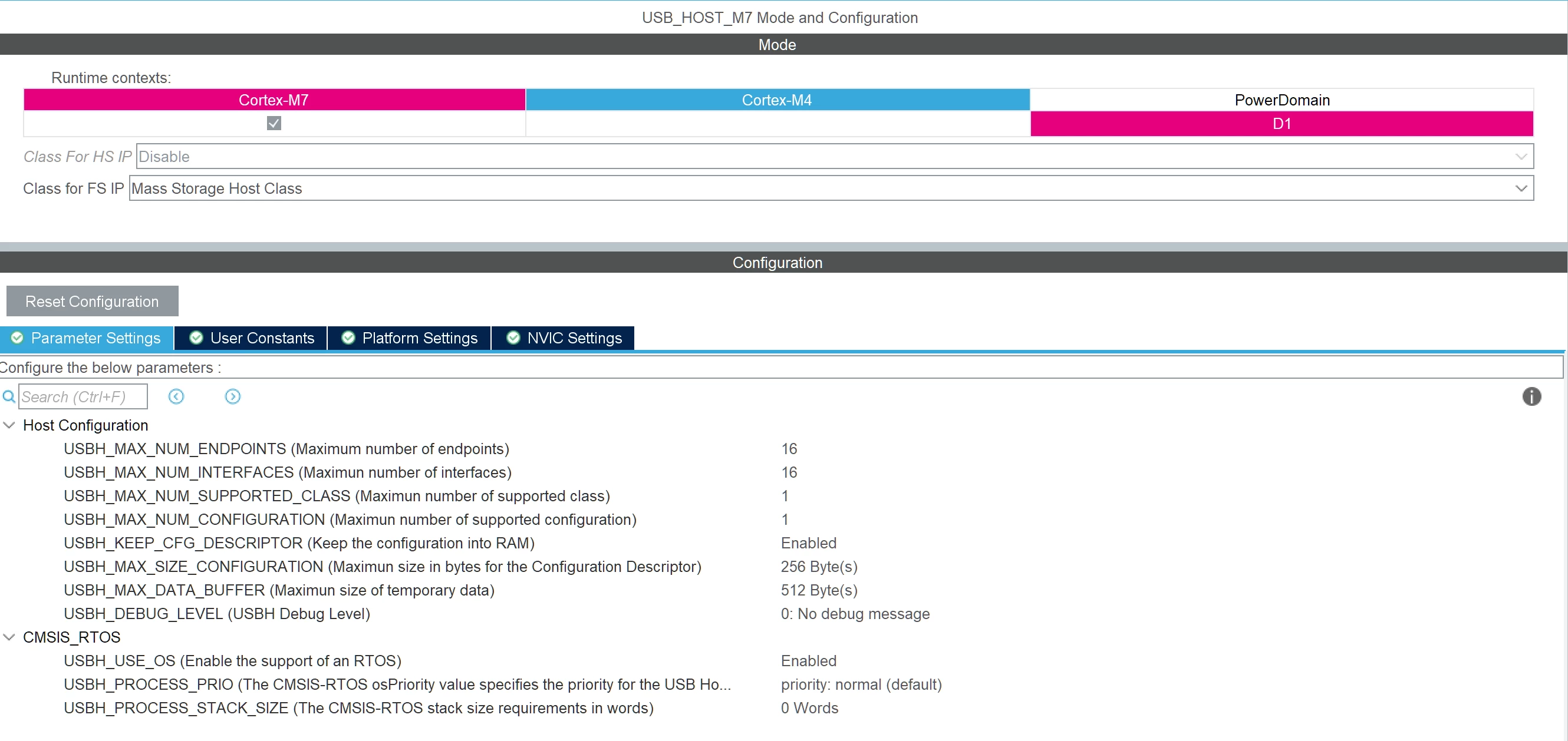

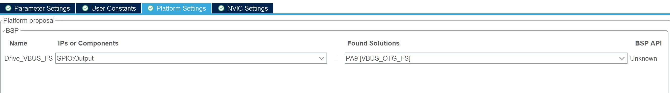

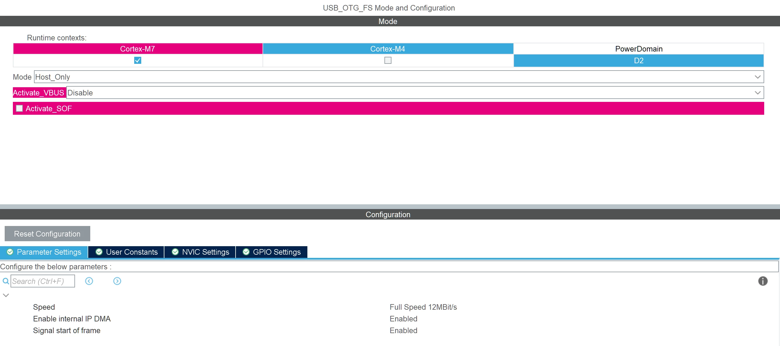

I configured USB_OTG_FS on STM32H745I-DISCO board using STM32CubeIDE.
Here are my settings:
My `MX_USB_HOST_Init()` function is called in `DefaultTask`.
It completes without errors.
`USBH_UserProcess()` is called whenever a USB disk is inserted to the port, with `HOST_USER_CONNECTION`.
Then, in only one of like 10 different pendrives - I get `HOST_USER_CLASS_ACTIVE` state, then everything works, I can use any format on the USB disk. Via FatFs library. I tested it with FAT32 and ExFAT. Both seem to work perfectly without any issues.
But I just can't buy another pendrive that works with that. 10 other pendrives don't work. I get `HOST_USER_CONNECTION` and that's it. Nothing. The device is not detected as mass storage device. What's especially infuriating, that it happens also with exactly the same looking pendrives. They have the same capacity, same speed, even the same look, branding and all. TBH: I have 3 pendrives that work with H745. 2 of them were bought together, in one batch, the other one is a random one found in a drawer. 7 others are various bunch. Some of them are bought to be the same model as the working ones - unfortunately despite looking exactly the same, they don't work. Some of them are just similar "16GB / USB2.0". They are all recognized both by Windows and Linux. They are all formatted identically, as only one MBR partition, FAT32. Partition tools report even the same sector sizes and all partition description fields. The working USB can be formatted as FAT32, ExFAT, not formatted at all, deleted partition table - no matter what, it is detected as mass storage device. The others just don't work at all. USB host detects when they are inserted, but the MSC class initialization fails.

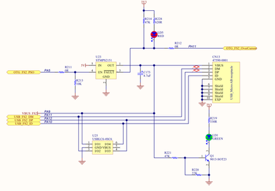

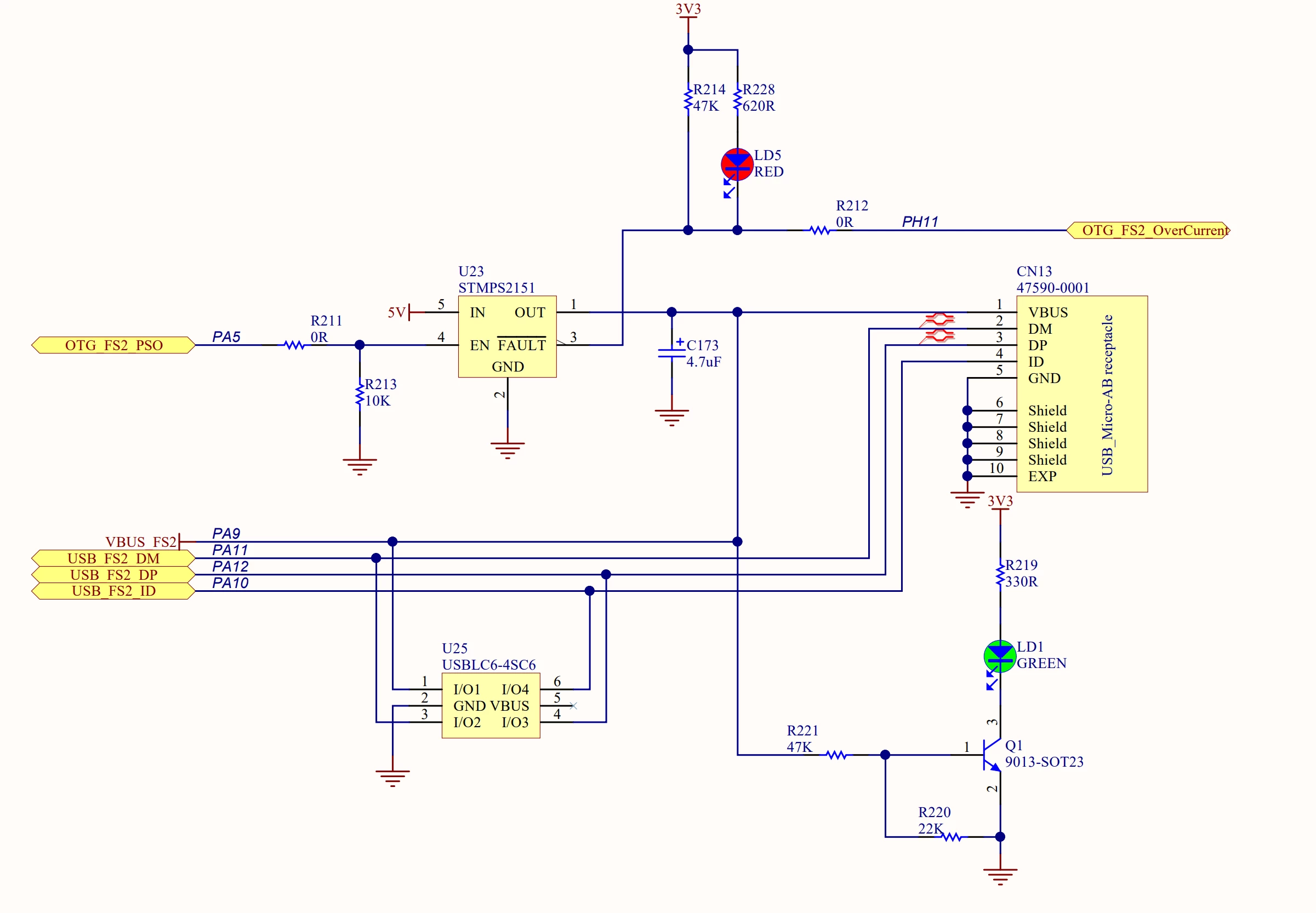

OK, here's silly me. I tested everything in software, not even looking at the schematic:
What is U23 doing here? I haven't check that chip online, but it looks like a kind of power supply for USB host. With PA5 MCU pin on EN (I'm guessing "enable"). So I threw him "1" to see what would happen. And guess what - every single USB stick and memory card on my table works perfectly. So - my guess is the single one SanDisk that worked without it just got VBUS from GPIO, it didn't need much current to run so by a twisted chance it was enough for it to work. All others probably needed more current to operate (at least in peaks) so they died during the initialization.

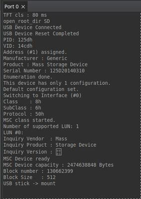

what could be helping, is if you get swo /swv data console working and see the debug messages from usb-host, looks like :
USB Device Reset Completed
PID: 5678h
VID: ffffh
Address (#1) assigned.
Manufacturer : USB
Product : Disk 2.0
Serial Number : 4939231172302356854
Enumeration done.
This device has only 1 configuration.
Default configuration set.
Switching to Interface (#0)
Class : 8h
SubClass : 6h
Protocol : 50h
MSC class started.
Number of supported LUN: 1
LUN #0:
Inquiry Vendor : VendorCo
Inquiry Product : ProductCode
Inquiry Version : 2.00
MSC Device ready
MSC Device capacity : 2785017344 Bytes
Block number : 122879999
Block Size : 512
USB stick -> mount

this is debug msg on swo :

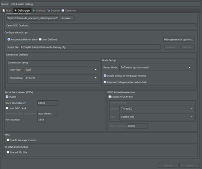

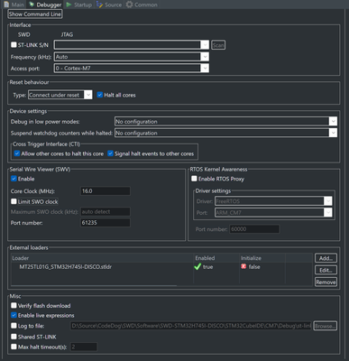

Here's my SWV configuration:
It shows nothing in any view.
I also tried to find the "USB Device Connected" text, I put a breakpoint there. The line is not called when the completely not working stick is used. It is called on some of the semi-working ones.

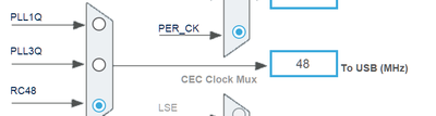

My guess something wrong happens before even USB Host starts. The sticks (not working ones) seem to behave randomly. I mean - some of them try to disconnect on start. One disconnects, reconnects, then even starts MSC class, then fails miserably when trying to mount the filesystem. One of them just doesn't trigger anything. Like no connection attempt, no disconnection. Their behavior changes to other random pattern of connection / disconnection when I change the USB clock to something other than 48MHz. However, my only working stick works when the frequency is set to 48-50MHz, doesn't work with any other frequency. When it doesn't work - it triggers the connection event all the time when it's inserted (like in a loop). When it's not physically present - no events, when it's present, I get connection attempts one after another.

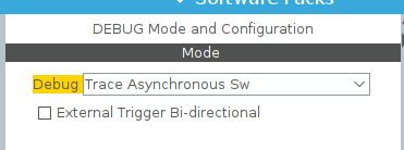

to get swv running was a long game...many hours.
1. swo is connected on your board ?
2. you set it in Cube... ?
3. you set core frequ. wrong - then its not working.
here my set: (with open ocd, but that should not be important)
in cube:

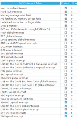

another problem: int priority - i just show you my working setting , i use no dma template, this i never got working:
i have sdcard and 2x usb host running, 1 usb msc (memory stick) and 1x usb audio host (not working, but STM has no working example, so difficult to make it run) and no dma on all, because problem with d-cache on H7 cpus.
test : switch off d-cache (dont enable it ) - makes any difference ?
