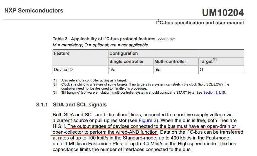

@Andreas Bolsch wrote:I2C usually (sic?) requires open-drain
"usually" ?
:thinking_face:
Surely, I2C inherently requires open-drain?
‎2024-07-31 10:27 AM
@VTara wrote:It seems I need to improve my knowledge in electrical details of MCU peripherals
Indeed - and standard interfaces such as I2C and SPI.
The MCU peripheral just implements the requirements of the standard.
