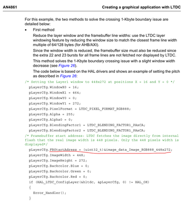

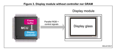

I'm currently working with the STM32F429IIT6 and using the LTDC to continuously output an image via parallel RGB + control signals. The image I'm trying to display is 854x480 pixels in 24-bit RGB888 format. The LTDC clock is running at 10.56 MHz.
According to ST’s Application Note AN4861, I am using the internal frame buffer to send parallel RGB signals along with synchronization signals to the LCD. The total image size is:
854 x 480 x 24-bit = ~1.2 MB,
which fits comfortably within the STM32F429’s 2MB Flash memory.

/********************  Bit definition for LTDC_LxCFBAR register  **************/
#define LTDC_LxCFBAR_CFBADD_Pos      (0U)
#define LTDC_LxCFBAR_CFBADD_Msk      (0xFFFFFFFFUL << LTDC_LxCFBAR_CFBADD_Pos)  /*!< 0xFFFFFFFF */
#define LTDC_LxCFBAR_CFBADD          LTDC_LxCFBAR_CFBADD_Msk                   /*!< Color Frame Buffer Start Address */
/********************  Bit definition for LTDC_LxCFBLR register  **************/
#define LTDC_LxCFBLR_CFBLL_Pos       (0U)
#define LTDC_LxCFBLR_CFBLL_Msk       (0x1FFFUL << LTDC_LxCFBLR_CFBLL_Pos)       /*!< 0x00001FFF */
#define LTDC_LxCFBLR_CFBLL           LTDC_LxCFBLR_CFBLL_Msk                    /*!< Color Frame Buffer Line Length */
#define LTDC_LxCFBLR_CFBP_Pos        (16U)
#define LTDC_LxCFBLR_CFBP_Msk        (0x1FFFUL << LTDC_LxCFBLR_CFBP_Pos)        /*!< 0x1FFF0000 */
#define LTDC_LxCFBLR_CFBP            LTDC_LxCFBLR_CFBP_Msk                     /*!< Color Frame Buffer Pitch in bytes */
