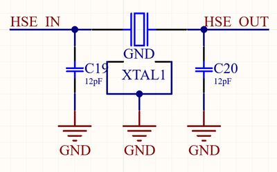

I used STM32F446VET7 on the board I PCB printed. When I use HSI, I can debug without any problem, but when I want to use HSE, SystemClock_Config(); function enters ErrorHandler().
Can you help me?
Can you show the HSE portion of your schematic?
In particular, the load caps on the crystal oscillator must be chosen correctly.

Roughly speaking, load caps should be around
CL1 = CL2 = 2 * (CL - 5 pF)
where CL is the load capacitance of the crystal.
cd00221665-oscillator-design-guide-for-stm8af-al-s-stm32-mcus-and-mpus-stmicroelectronics.pdf
I use 16 MHz ECS-160-12-33-AGN-TR with 2x12pF cap.
Debug the code, see where and why it's entering ErrorHandler.
HSE design seems fine.
The error was in hardware. I resolder components and its work just fine.
