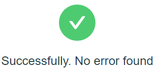

I have created a custom inverter board using STMC Board Designer. And there is no error reported by Board Designer.

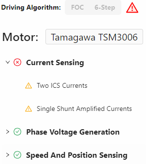

However when I use the inverter board to creat a workbench project, it tells me "Current Sensing" item has some errors without details. So I have no idea about what is the exact error and how to solve it.

On STM32H7 series, ICS current sensing is not supported as mentioned on Workbench Release note, and only "ThreeShunt_AmplifiedCurrents / DualADCs" configuration is supported for the moment.
