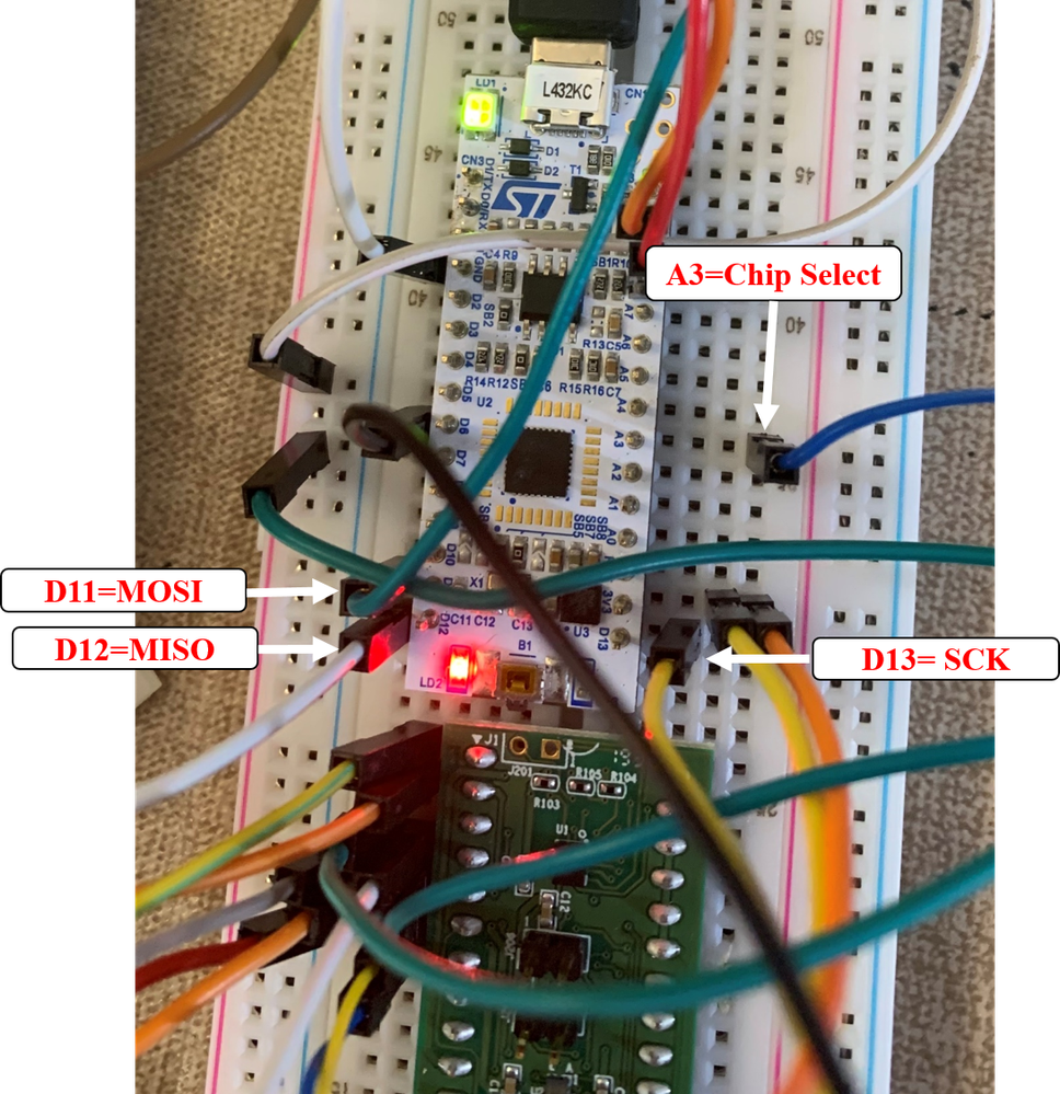

Hi I am going to get sensor data from the BMI160 through SPI with ST32L432KC. I appreciate it if anyone can help me with how I can configure the SPI. Thanks
SKaze
13 REPLIES 13
What have you tried? Where are you getting stuck?
SKaze
Thanks for your reply. Please kindly find the pin connections for SPI connections.
Also, the piece of the code that I am using to get gyro data is as follows. In this code, I followed the procedure explained in the Bosch GitHub, here. The problem here is that it doesn't update the gyro variable. Also, tested with the logic analyzer. Seems it is not changing on the pins.
Thanks

Would have chosen I2C myself.
How have you got it connected? Written any software for this, or expecting others too?
Some SPI interface examples in the BSP code for the example boards, try porting that into your target.
https://www.bosch-sensortec.com/media/boschsensortec/downloads/datasheets/bst-bmi160-ds000.pdf
Look very Arduino, not HAL
Is this not working? Is it compiling?
If pins are not sending the signals, ensure they're configured correctly. Look at the GPIO registers. Looks like Arduino code, which I'm not really familiar with.
Yes, this program is written in Arduino IDE. It compiles but doesn't work.
Am I following the right procedure here?
Hard to say, I suspect the approach you're taking will take many man-days to execute.
I'd start with reading/writing the registers of the BMI160 first.
See if that were sufficient, and then decide if I needed to port all the library functionality, or just salient portions.
Either way, need to focus on the low-level stuff first for there to be any chance of getting the high-level stuff to function.
