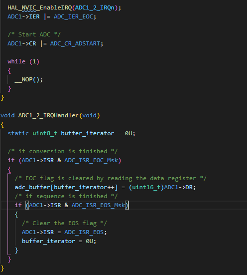

Hello Community,
I'm currently programming a framework for the STM32F3 ADC. However I ran into a problem. I want my ADC to run continuously. Moreover I expect "long" delays between reading the channels. I thought, this is no problem, since the ADC has the Auto Delay functionality. I attached a similar program flow and like my real program, the EOS flag is always set after the delay and only buffer[0] is written. I already searched the reference manual as crazy. Can someone see my fault?

Does it work if you take out the HAL_Delay(1); line? Probably all the conversions are overwriting each other. You need to use DMA for multiple channels, or be more responsive to the EOC flag.
‎2020-07-30 12:25 AM
Hmm, no it doesn't actually. It worked as I used (EOC-) interrupts for it, however I want this to be independent from DMAs and Interrupts
‎2020-07-30 12:49 AM
This code works. But I really don't get it. I thought the Auto Delay waits with the next conversion until the DR is read (EOC flag cleared)

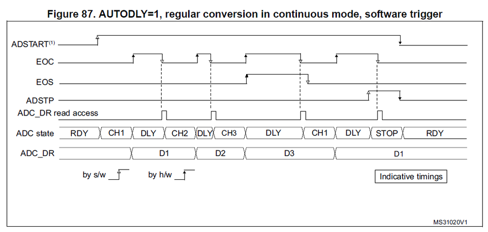

This figure suggests your original logic would work just fine:
Probably something else you're missing.

‎2020-07-30 11:23 AM
>> Don't you observe it in debugger?
> I do
Okay so that's why the conversion doesn't stay in the DLY state - you read out ADC_DR by the debugger, thus clearing EOC. Exactly as in the "classical" case of UART and SPI I am talking in that link, and discussed here so many times.
Stop observing ADC by debugger, observe only the memory where the program writes the data.
