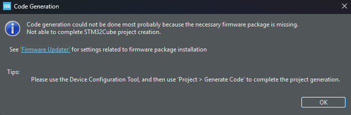

So I unchecked Virtual COM Port in the ioc config and USART3 seems to be available now. But I often get this window msg from time to time. I'm sure I keep checking for updates but still get it oftentimes.
Andrew Neil
That's just telling you that the UART is being managed by the BSP - so you don't need to configure it yourself.
So did you see the Firmware Updater - as it says?
Sure thing! but it keeps coming back from time to time..
Now works fine though!
