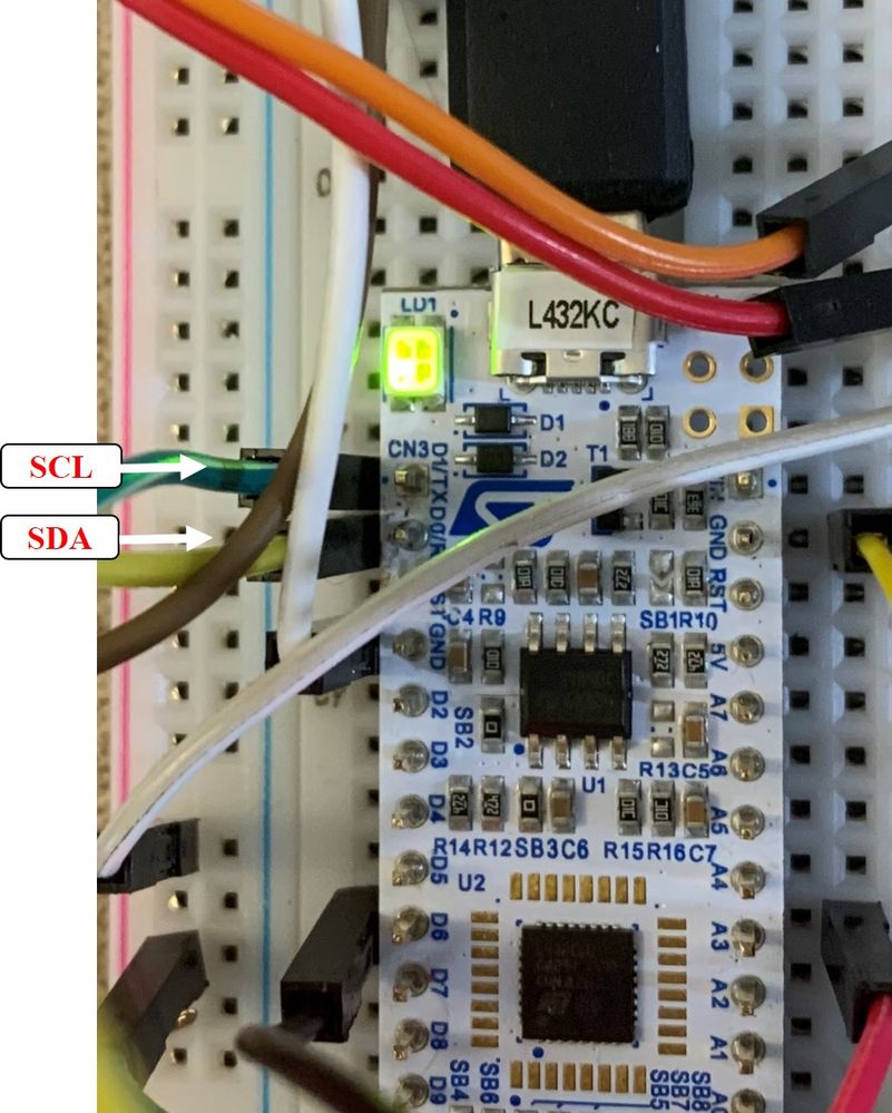

@Community member​ , Here I am going to use the wire.h library written for i2c connection. Also the pins used for SDA and SCK are as follows:
Is it true to use these two pins for i2c?
Thanks
You might want to edit that when you get home, guessing you're on a phone, or having a stroke, or drunk
D1 PA9 I2C1_SCL
D0 PA10 I2C1_SDA
Yes..
"Error Compiling" going to need to be more specific about the lines and code the compiler is complaining about.
