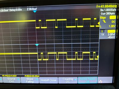

Here is a scope capture from the Rx pin on the can transceiver.

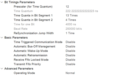

Here is my ioc config

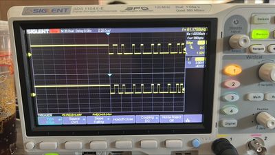

This is a scope of the Tx pin, going into the can transceiver.
I haven't been able to receive the messages in the code. It gets stuck at the while code line, and doesn't move from it, but I was able to see it on the scope and on the USB PEAK CAN.

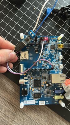

The grey wire is Rx and the Purple wire is Tx. I already checked to make sure that the transceiver is getting 3.3V.The top PIN should be PB8 and the one beneath it is PB9 (according to the card that came in the packaging for the STM.
