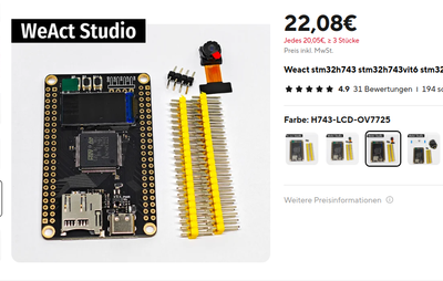

Right, or a cheaper "nucleo like" board (as i have also) , just need buy an st-link (if you dont have):
https://de.aliexpress.com/item/1005005852859518.html
or with camera...
https://de.aliexpress.com/item/1005006632336183.html
