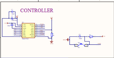

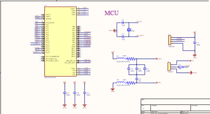

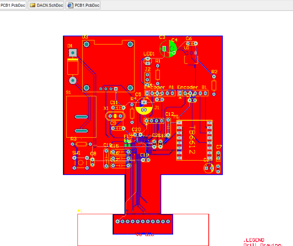

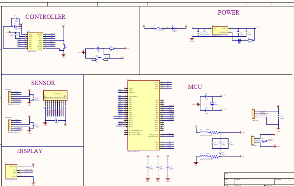

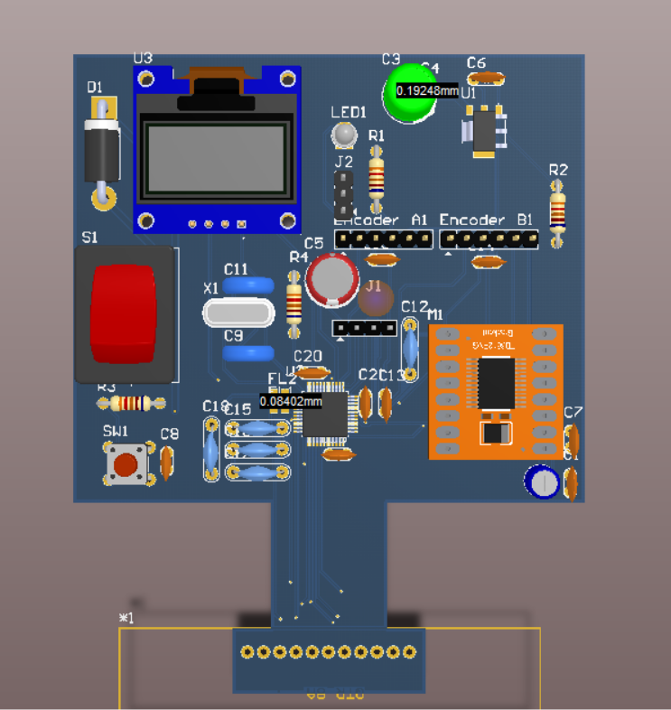

Hello everyone,
I am working on a custom board using an STM32F103 (LQFP48) and connecting it via ST-LINK V2 using the SWD interface.
However, when I try to connect, STM32CubeProgrammer reports:
Error: No STM32 target found!
The log shows that the ST-LINK is recognized, the voltage reads ~3.16V, but the MCU cannot be connected.
Additional details:
- ST-LINK V2 wiring: 3V3, GND, SWDIO, SWCLK, NRST
- Tried “Connect under reset” mode and reduced SWD frequency to 50 kHz — still the same error
- The board has a 10kΩ pull-up resistor on NRST and a 100nF capacitor to GND
- Power supply is stable at 3.3V
- Continuity test from the SWD header to MCU pins shows SWDIO (PA13), SWCLK (PA14), and NRST are all connected
- MCU is brand new and has no firmware flashed yet
My questions:
1. Besides wiring and power supply issues, what other reasons could cause ST-LINK to fail detecting the MCU?
2. Is there any way to check if the chip is locked at RDP Level 2 when we can’t connect at all?
3. Are there recommended methods to test SWD directly on the MCU pins to rule out PCB routing problems?
Thanks in advance!Ảnh chụp màn hình 2025-08-10 105059.pngẢnh chụp màn hình 2025-08-10 105105.pngẢnh chụp màn hình 2025-08-10 105108.pngẢnh chụp màn hình 2025-08-10 105113.pngẢnh chụp màn hình 2025-08-10 105117.pngẢnh chụp màn hình 2025-08-10 105121.pngẢnh chụp màn hình 2025-08-10 105251.pngẢnh chụp màn hình 2025-08-10 105313.png

1. Is your st-link V2 like a stick?
Then it has no working nrst/reset , try connect mode: software reset.
2. Is boot0 on GND ?
3. If you buy a new CPU from an official distributor, it's not on RDP 2 , because this would be a useless piece of recycling trash.
MM..1
Chief III
Your schematics is unreadable, but chceck datasheet if VBAT can be unconected...
