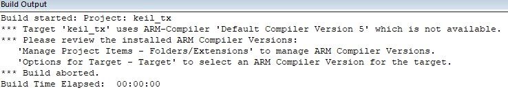

Hi! I am working on a project using a STM32f407 board, I wrote the code but when I try to load it, an error shows. I saw a similar problem but the solutions didnt work for me. Here is the build output0693W00000aIHLuQAO.jpg0693W00000aIHImQAO.jpg

Hi! I actually tried that but it didnt work because I think the problem here is in the compiler as the build output says target 'keil_tx' uses ARM-Compiler 'Default Compiler Version 5' which is not available. But I do not understand what should I do
Pick a compiler that IS available, or perhaps reinstall Keil properly?
Did it install Version 6, or were you trying to use the GNU/GCC compilers?
You can't download the .AXF because the build did not complete.

Indeed, you may need to change the missing compiler. Try to change default ARM compiler version and see if it works.

Keil was installed properly, the issue was with the compiler and as I said I am a beginner and only getting familiar with this software. the solution is here :
https://www.youtube.com/watch?v=u5SrhXUHYu4&ab_channel=EasyElectric
Then try to select compiler v.6. If this won't help, the Keil support is here.
Thank you! It is working perfectly!
