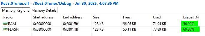

I'm having the same problems too. Just updated to the newest cubeIDE, and now I can't program my micro because the compiler complains of a lack of memory space. STM32G474RB.
Not close to filling up the flash, so I'm extremely confused what changed.
I also tried switching back to an older revision of the software I'm working on, that i KNOW compiled and uploaded before. It also now fails with the same error.
Edit:::
yep, can confirm it's stm32cubeprogrammer related. I swapped the unpacked older version 2.2.1 into the new 2.2.200 folder, and now I can program again. So something's amiss with cubeprogrammer.

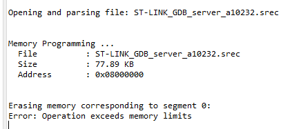

Dec 8, 2025 8:41 PM UTC
I'm having this problem again after recently updating stm32CubeIDE.
Why would this not be a problem previously, but then only crop up now? This is on an STM32G474RBT6.
Opening and parsing file: ST-LINK_GDB_server_a15356.srec
Memory Programming ...
File : ST-LINK_GDB_server_a15356.srec
Address : 0x08000000
Error: Operation exceeds memory limits
Error: failed to erase memory
