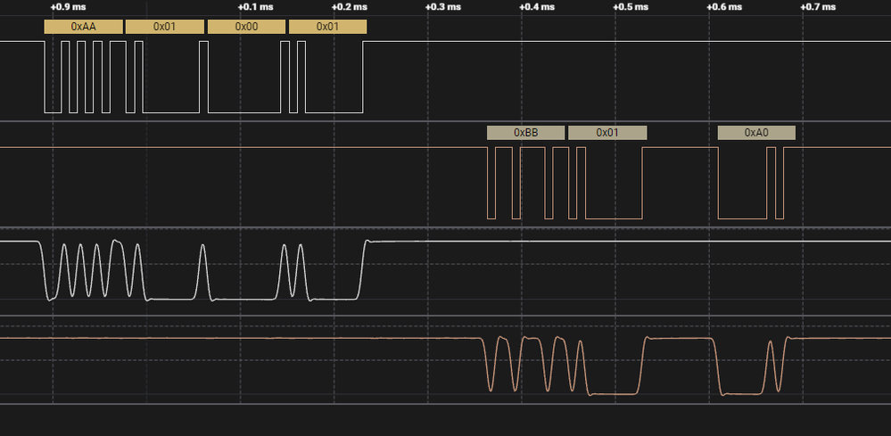

Unfortunately, I am running into a problem, where when I try to read data from the BNO055, the UART doesn't seem to pick it up. I checked with a logic analyzer and I can confirm that the BNO055 is responding as expected, but the STM32 doesn't seem to realize that anything has arrived. I set the wait time for HAL_UART_RECEIVE to HAL_MAX_DELAY, and it just waits forever.
In the below picture, a request is sent for the BNO055's id (0xA0). This command is composed of a start byte (0xAA), Read or Write (0x01 for read), What is being read (0x00) and how many bytes of data the BNO055 should send back (1, 0x01).
The response back from the BNO055 is success (0xBB), length of the data (0x01) and the data (0xA0).
0693W00000aHLg6QAG.pngI took this capture very close to the STM32 UART GPIO, so I can be reasonably confident that the transmission reached the other side successfully, and the BNO055 successfully interpreted the command and responded appropriately. However, the STM32 doesn't seem to have realized that anything has arrived.

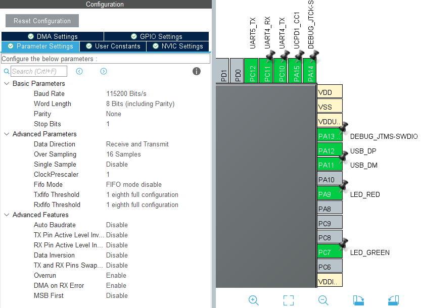

This is the current configuration I have for UART4, which I am using to try to communicate with the BNO055.

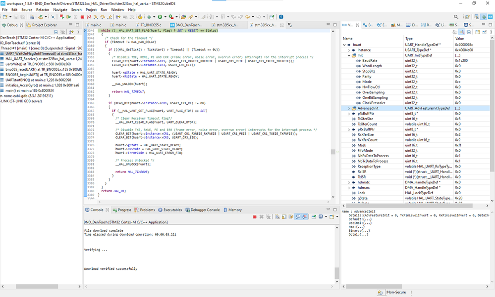

Is this the area you were talking about? I was also poking around in the Register and SFR sections, but I'm not well-versed enough to notice when something is amiss. It didn't look like any errors were getting thrown. By all accounts, it's just using HAL_MAX_DELAY and running forever, looping inside the UART_WaitOnFlagUntilTimeout() function.

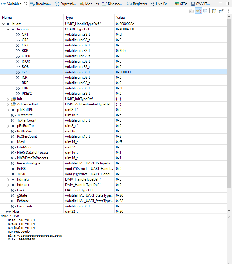

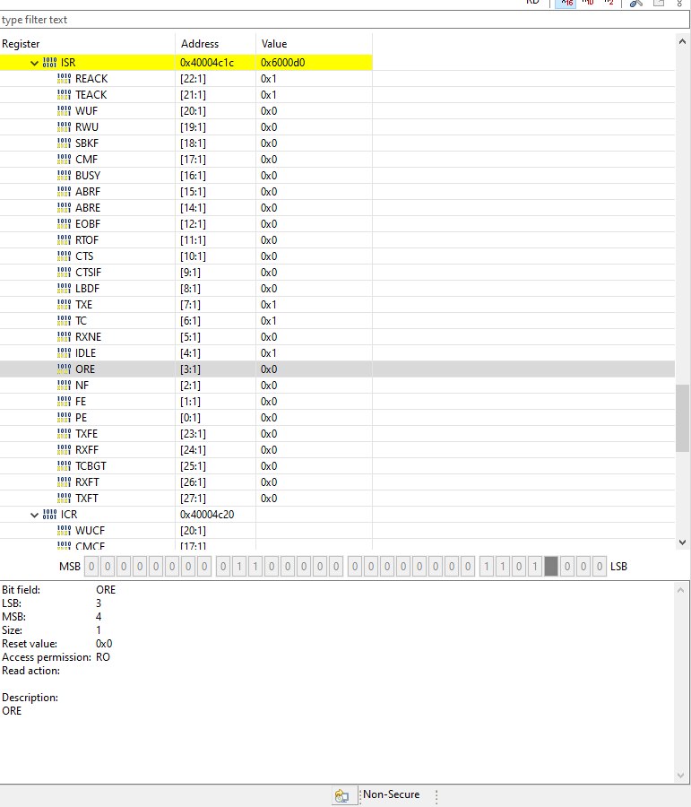

Hi @ESpra.1​
You could check in your huart->Instance->ISR if ORE bit is set or not. If set, this indicates Overrun error has been detected.
ORE bit set is preventing further reception. In order to have Reception active again,you should clear this flag, by writing corresponding bit in ICR.
Just in case ...
I'll look into that. For now though, this is what I'm seeing
