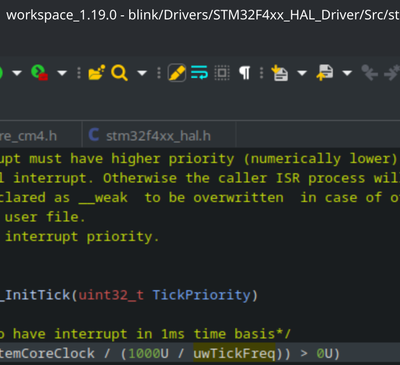

This runs CubeIDE under X11, which allows STM32 project creation (CubeMX launches correctly), but the interface is blurry and not crisp on my HiDPI 4K screen.

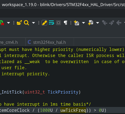

export GDK_BACKEND=wayland
...the UI becomes sharp and scales properly (as expected), but CubeMX fails to launch when trying to create a new project (no MCU or board selection dialog ever appears).
