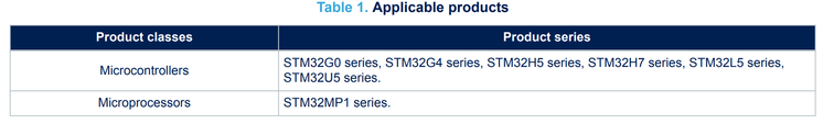

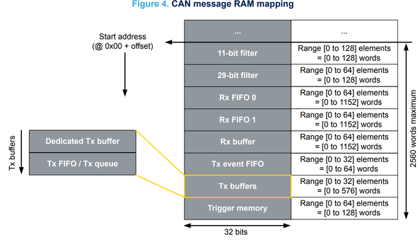

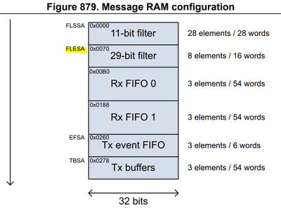

AN5348 - FDCAN peripherals for STM32 product classes does not mentioned that anywhere. The max FIFO/queue size discussed in AN5348 is very reasonable 64 elements. Consequently, all the FDCAN memory flexibility and RAM management discussed in AN5348 section 4.2 practically does NOT apply to U5, H5, G0, G4 and L5 families. Perhaps it applies to H7 family only. See FDCAN_RXF0S[F0FL] register description in the corresponding RMxxxx document. In particular, on STM32U5 FDCAN RAM config is fixed - (RM0456, Figure 879. Message RAM configuration). E.g. if you need just one RxFIFO buffer (FIFO0), you probably cannot use RAM reserved for FIFO1. and make it bigger. That is very unfortunate. One may think: OK, so I just configure selective hardware filters to catch only those messages I need, but one can configure just 8 'extended' 29-bit filters and memory reserved for 28 11-bit filters will remain unused. That is a pity, but that is not all. Rx buffers discussed in AN5348 section 4.3.2.2-4.3.2.3 just do not exist. The same is true Tx buffers, they do not exist. RM0456 in Figure 879 mentions them, but they mean Tx FIFO/queue only, not dedicated Tx buffers.
I do not want to call this 'false advertisement', but it came as a big surprise - especially for STM32U5 with plenty of SRAM. FIFO/Queue size limited to 3 elements perhaps would be bearable if I could use extended ID filter list (min 20 elements required) to receive only interesting NMEA2000 messages and avoid software filtering. However, I need to use classic filters (ID+mask) and only 8 extended ID classic filters can be defined. Dual or range filter is not an option. Functionality is there, it was just purposely and seriously limited in this supposedly top product for no apparent reason. It is just poor-man implementation and big STM32U5 disappointment.

Fully configurable 10k FDCAN RAM documented in AN5348
The actual STM32U5 FDCAN fixed 848 byte RAM structure documented in RM0456

I want to add my complains to the choice to use a so limited queue. It make totally no sense to have such limitation also in a Mcu like G4 or H5. What was the additional cost to put 32 elements instead of 4? We are not more in 1995.
And just update the documentation. From the general application notes it seems all the FDCAN equipped uC have the same capability but there is a reeeeeeally difference between H7 and "the others".
