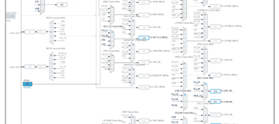

I am using STM32H743 nucleo board on one of my design. On my board I have installed nucleo board on board to board connector. For FDCAN interface we are using TCAN3414 transceiver IC. Our bit rate is 1MHz and data rate 2MHz for FDCAN communication on board. We are interfacing the FDCAN with DigiSoM board having transceiver TMC2517. After some packet transmission i observed that communication link is down. CAN bus is not working. On resetting the controller communication starts again for sometime and again stops. I tried replacing the STM32H753 board with STM32H743 and i have not observed any communication issue on that particular system. On other system I am already having STM32H753 but still I am facing the same issue. I am using normal wires for GND CANH and CANL connections of length 15cm max. I tried reducing the baud rate till 250kbps but same issue. I have checked the signal quality on oscilloscope which looks fine with ringing effects. We are using MATLAB modelling for all this testing. Below is the cubeMX setting we are using for FDCAN1/2. Can you please help me what may be the issue here. Because on some nucleo boards with STM32H753ZI i have not seen any issue.

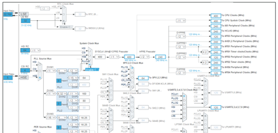

I have changed the clock frequency of MCO_CLK to 5MHz using external crystal for STLink IC and it started working (FDCAN bus is intact) . But when I introduce the additional node on the CAN bus I have seen some drops in the packets. Below is the setting for clock and I/O parameters I did for FDCAN. There is one more issue I observed. I tried reverting the clock to 8MHz using STlink firmware upgrade tool. Now in MATLAB it is showing no STM32 MCU detected. I changed the setting back to 5MHz and it started working. Is it reversible once we change freq to 5MHz using external crystal? If yes, then why I am unable to detect MCU with internal clock HSI of 8MHz??
Please comment
