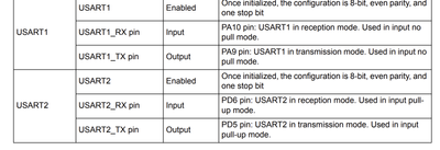

In AN2606, it goes into pin specific detail about the pins when look at your specific chip line.
Does this mean that I am limited to those specific pins in order to use the bootloader and that I cannot used an alternate assigned pin?

For the Bootloader, yes you are limited to the pins stated on the tables of the AN2606. But you can still use the open Bootloader that can work on different pins and peripherals. More details available on the readme file ofthis GitHub repository  .
