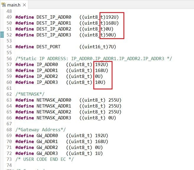

I tried running the LwIP_TCP_Echo_Server app on the Nucleo Board H7S3L8 (MB1737-H7S3-L8-B02) using STM32CubeH7RS\Projects\NUCLEO-H7S3L8\Applications\LwIP\LwIP_TCP_Echo_Server sample code.
The code downloaded fine, but TCP communication didn’t work.

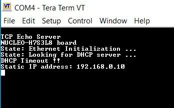

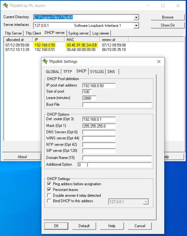

I started a DHCP server using Tftpd32 software, but the MCU didn’t get a DHCP IP and showed a static IP (192.168.0.10) instead.

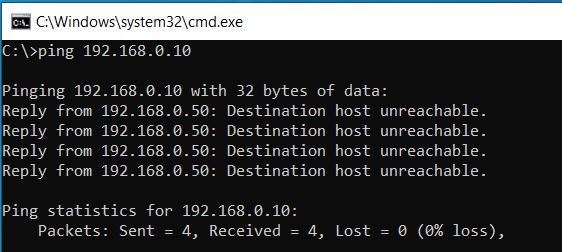

I tried pinging the MCU’s static IP from my laptop using a straight Ethernet cable, but it failed.
I tested with both crossover and straight Ethernet cables and used a Wi-Fi modem/router as another DHCP server, but the result was the same.
I also tried other sample codes (LwIP_UDP_Echo_Client, LwIP_UDP_Echo_Server, LwIP_TCP_Echo_Client, LwIP_HTTP_Server_Raw), but the result was the same.
I followed the steps in the Readme file and enabled the XSPI2_HSLV=1 for high-speed I/O.
Did I miss any steps? Screenshots are attached for reference.
MCU Comm3 serial responseMCU Comm3 serial response

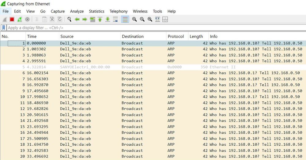

Wireshark packet while sending echo command from Laptop to the MCUWireshark packet while sending echo command from Laptop to the MCU
DHCP server - PC utility TFTPD32DHCP server - PC utility TFTPD32

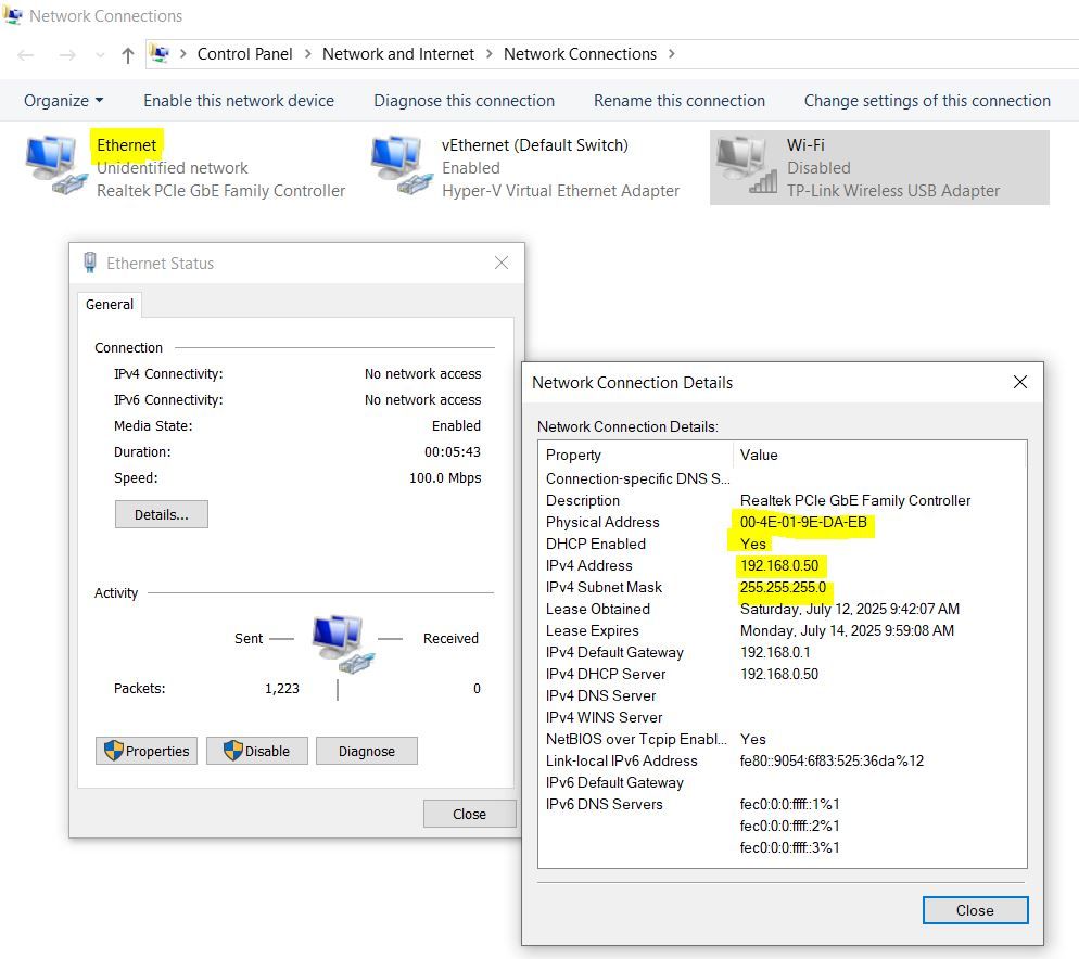

Laptop IP Address configurationLaptop IP Address configuration

Additional Screenshots

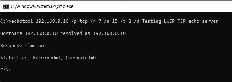

echo request from Laptop to the MCUecho request from Laptop to the MCU
Main_h fileMain_h file

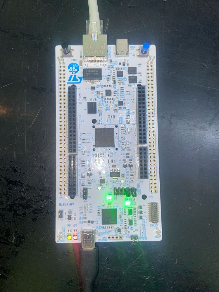

MCU Board ImageMCU Board Image

It looks like your board does not respond to ARP at all. Check if it receives any eth packet (set breakpoint in low_level_input).

Hello @Sajidaap,
Please try changing the JP5 jumper position to 3V3; this should resolve the issue.

Yes, it is safe to do so. As can be seen in the Getting Started with STM32H7Rx/7Sx MCUs Hardware Development application note, the voltage range for VDDXSPI2 is between 1.62V and 3.6V. Therefore, changing the jumper JP5 to 3V3 should allow the example to work correctly.

It's worked when I changed the jumper JP5 to 3V3 while the XSPI2_HSLV bit is enabled.

echotoolechotool
DHCPDHCP
Yes, my recommendation was to set the jumper to 3V3 while the XSPI2-HSLV option is enabled. I’m glad to hear that this resolved your issue. Regarding your question, the highlighted section refers to the VDDIO_HSLV option byte, which must not be activated when the device operates above 2.7V, as this could potentially damage your device.
