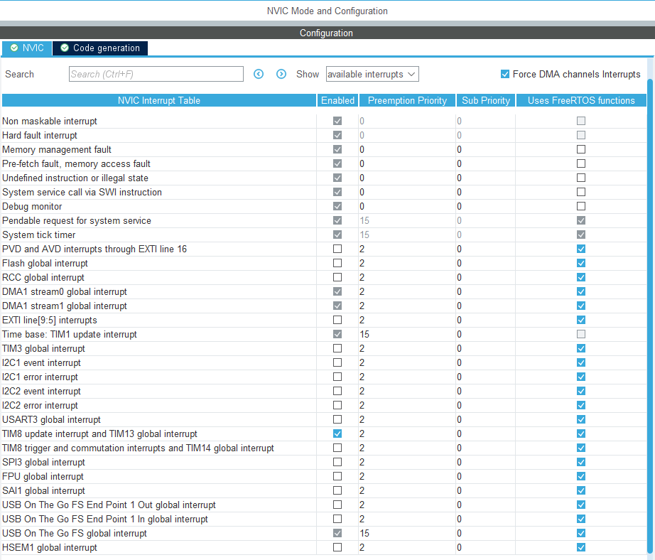

I am using a STM32H743 with a W25Q128 external flash memory running FreeRTOS and FatFs. USB is configured for mass storage, to copy files from a computer to the flash memory. The following function is used to list all the files and directories in a directory and put them in a list:
void IndexFilesInDir(const char *path, SFileMgrList* psReturnList) { FRESULT res; DIR dir; FILINFO fno; uint8_t u8Count = 0; res = f_opendir(&dir, path); /* Open the directory */ if(strlen(path) != 0) { strcpy(&psReturnList->cFilename[0][0], "..."); psReturnList->bIsDir[0] = true; psReturnList->bHasParentDirectory = true; u8Count++; } else { psReturnList->bHasParentDirectory = false; } if (res == FR_OK) { for (;;) { res = f_readdir(&dir, &fno); /* Read a directory item */ if (res != FR_OK || fno.fname[0] == 0 || u8Count >= 128) break; /* Error or end of dir */ if (fno.fattrib & AM_DIR && strstr(fno.fname, "System Volume Information") == NULL) { psReturnList->bIsDir[u8Count] = true; strcpy(&psReturnList->cFilename[u8Count][0], fno.fname); u8Count++; } else { char *dot = strrchr(fno.fname, '.'); // Is this a .wav file? if (dot != NULL && strcmp(dot, ".wav") == 0) { psReturnList->bIsDir[u8Count] = false; strcpy(&psReturnList->cFilename[u8Count][0], fno.fname); u8Count++; } } } psReturnList->endIndex = u8Count; f_closedir(&dir); } else { printf("Failed to open \"%s\". (%u)\n", path, res); } }

This is based on the example from the FatFs website. Everything works fine until I start processing some audio data (= lots of SAI DMA interrupts). Then f_readdir returns random garbage or does not all the files or it lists files from another directory from time to time. Here's what I've tried and observed:
- Disabling the caches doesn't solve or change the problem.
- Reading and writing files via USB always works perfectly fine, even under high load conditions. I conclude from this that my low level SPI driver for the W25Q128 works fine.
- FatFs is only used in one Task.
- The microcontroller is not overloaded, other RTOS Tasks still work fine. Temporarily removing all the other tasks does not help or change anything.
Does anyone have any idea what could be causing this behavior?
Thanks!
Update: The problem was solved by implementing large data transfer via DMA when reading a sector.

AScha.3
>under high load
can you tell -
- data rate on SAI (in or out) + mode (INT , DMA (+ blocksize then))
- data rate on fatfs -> USB stick (i assume)
- int priorities you set
Hi @AScha.3
SAI is running at 48 kHz or (worst case) 96 kHz with 24 bit. That means 4 bytes per channel = 8 bytes per sample = 768 kByte/s. Mode is DMA and the interrupt is triggered for every sample, because I am doing some zero latency FIR filtering.
Data rate for the USB Mass Storage is around 70 kByte/s write (the flash memory is quite slow) and up to 250 kByte/s read. These data rates still work for the audio running at 48 kHz. At 96 kHz it drops down to 30 kByte/s write for example. But it still is 100% reliable. I never get any read or write errors via USB with audio processing running at the same time.
However, when I am just listing the files (not even reading or loading files) using FatFs on the STM32 while audio processing is running I get random garbage every second to fifth time I read a directory. So, the data rate is really low. When I stop the SAI DMA it's 100% reliable as well.
And these are my NVIC settings:
Thanks!

its late now...but in brief : your problem is int priority.
ie. i have on H743 (and now on H563 beginning) an audio player running. :)
read from SDcard or USB stick, data out with SAI /DMA circular (same you, almost); with FatFS.
when playing cd audio 44/16 , cpu load is about 3% ; with FLAC file at 96k and 32bit also no problem, cpu still under 40% load; and decoder + 2x biquad filter (double precision) needing most time here, cpu at 200MHz clock, to run cool.
so "play" with your int priorities ! all on same level is nonsense.
try: usb 4 , DMA 9+10, tim so important? if not, 12.

@AScha.3
I don't understand how interrupt priorities could be the issue here. But I tried what you suggested and also tried different combinations. No success. SPI communication with the W25Q128 is not in interrupt mode. I disabled the timer, it's not needed anyways. USB enabled or completely removed makes no difference either. Also, since a lower number means higher priority, wouldn't it make more sense to keep the DMA interrupts low around 2 (= high priority) as these are the most important and time critical thing? And set the USB to a high number (= very low priority) since it is not time critical at all?
I just wanted to illustrate that the USB Mass Storage data transfer works 100% reliable, even under high load despite having a very low priority. And it shares almost identical code for the diskio. Whereas simply listing filenames (not a lot of data to read, only takes a very short amount of time) from the FreeRTOS task fails frequently.
