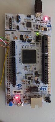

I have a stand alone ST-link/V2 and I need to use it to flash the FW to a STM32H743 Nucleo-144 "Nucleo-H743ZI"
I removed the two jumpers on CN4 to disconnect the on board ST-Link
and Connected the following Signals, the table show mapping from Nucleo CN11 pin
| Signal | Nucleo CN11 Pin# | ST-Link ICD20-Pin# | |
| VDD | 12 - 3.3V | 1 - MCU VDD | |
| GND | 8 - GND | 4 - GND | |
| SWDIO | 13 - SWDIO | 7 - SWDIO | |
| SWCLK | 15 - SWCLK | 9 - SWCLK | |
| NRST | 14 - NRST | 15-NRST | Optional |
the board is powred through CN1
The Programmer is connected but the target Volatage is not 3.3V
and when I try to connect I get this error

2025-06-12 5:55 AM
Is the nucleo board powered? If so, how? The programmer does not provide power over pin 1. It has VDD on pin 19 if you want to use that.
2025-06-12 7:11 AM
The Nucleo is powered through the USB connector CN1
I am connecting pin1 of the IDC20 connector to allow the programmer to monitor the supply voltage of the microcontroller.
2025-06-12 7:19 AM - edited 2025-06-12 7:19 AM
Evidence suggests otherwise, no? Are any LEDs on the board on?
Show a picture of the board with jumper positions visible. Should be configured for USB power.
Why use an external programmer on a board that has an on-board programmer? Perhaps you damaged the hardware and this is a last ditch attempt to use it?
2025-06-12 7:39 AM
LD4(COM) and LD6(PWR) are turned on
and CN4 jumpers are removed
2025-06-12 8:01 AM
LD7 (overcurrent) on indicates the board has potential hardware issues. Is it possible something on the board was damaged?
Why do you want to use an external programmer to program a board with an on-board programmer? If there is a hardware problem, this will not circumvent it.

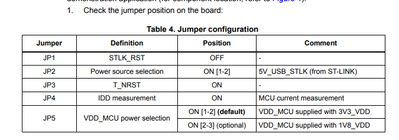

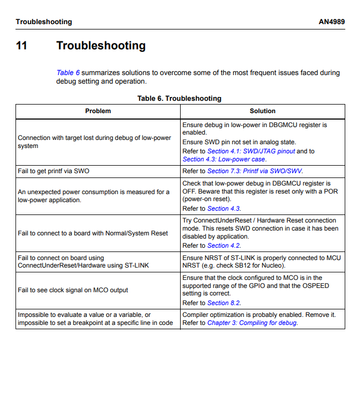

2025-06-15 11:32 PM
Hello @Alzomor ,
Try the "Connect Under Reset" mode.
Check the jumper positions
2025-06-16 5:51 AM
> 13:29:41:518 : Voltage : 0.58V
It's not going to connect when the target voltage is 0.94 V or 0.58 V. That's the problem that needs fixed.
