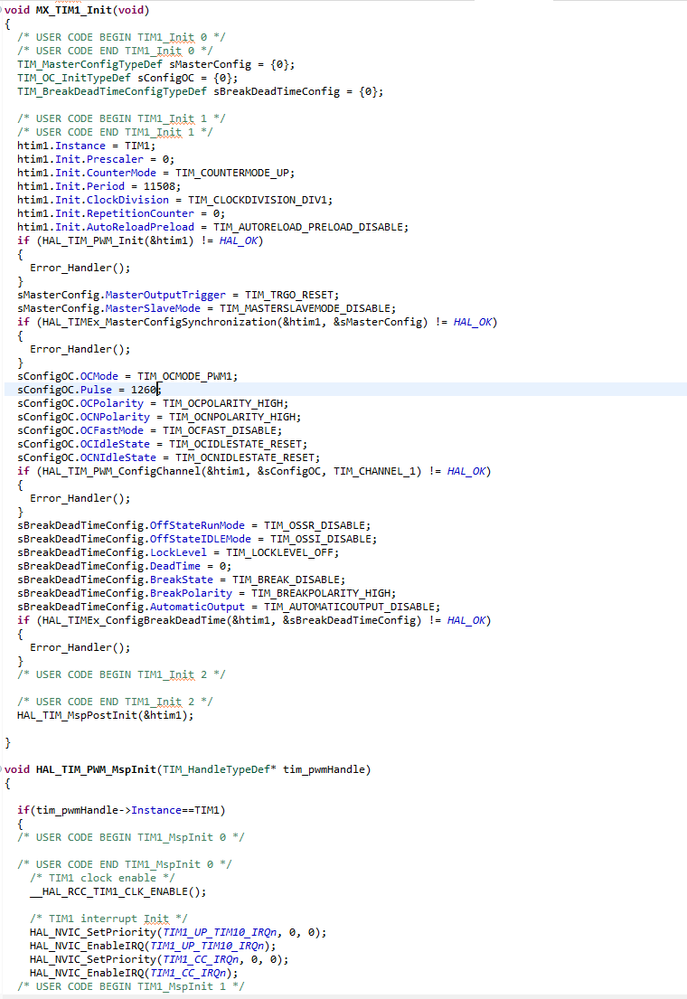

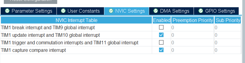

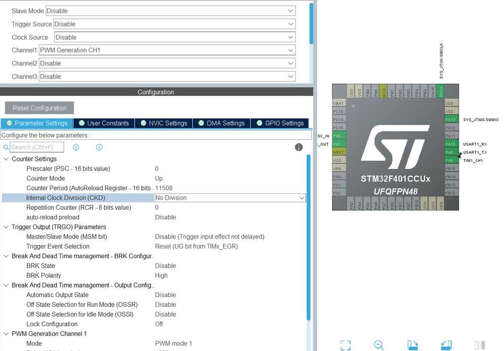

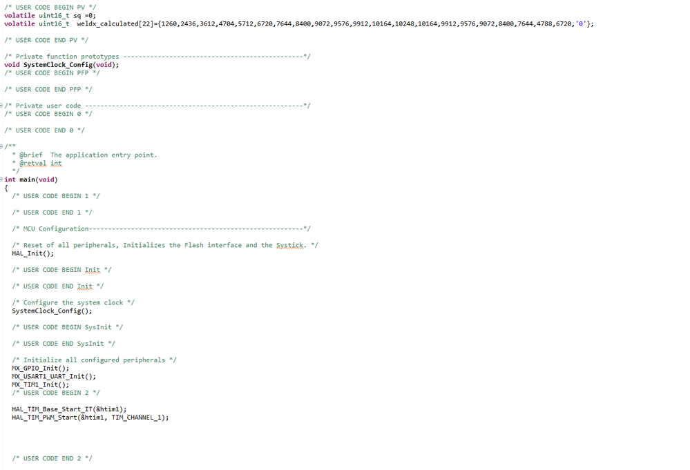

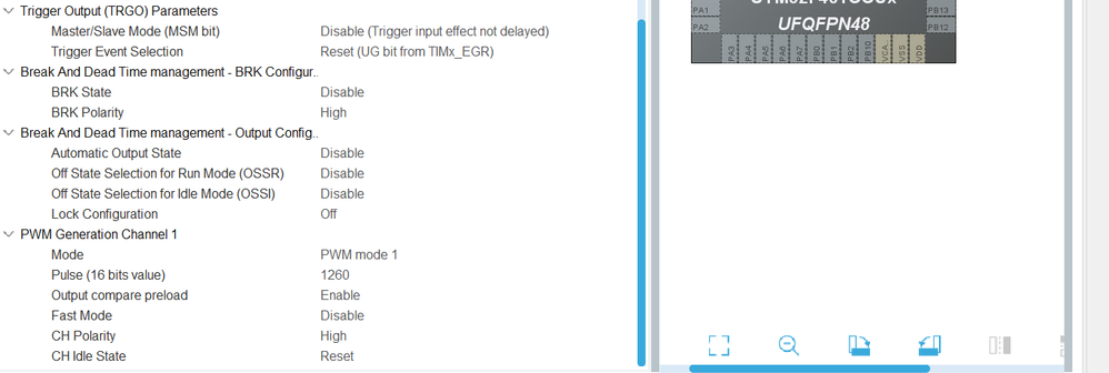

Yes your right , I'm doing it the other way now , Firstly I tried using Compare Capture Mode but upon using SetCompare in the interrupt I'm unable to change the Duty Cycle. No Matter what the pulse value is it just outputs a constant 7.3kHz.I left that for now and am using PWM Mode. I'll show the settings I've done to achieve .It does work correctly ,but it seems that when using a lookup table to go through 22 values in the array , some duty cycle PWM is not what it should be , probably missing out on some settings I believe ? Thank you @TDK and @waclawek.jan for your replies .This a very simple implementation that should work, but I'm getting different pulses ,also lastly it seems that the last  value before null terminating character isn't being outputted .
Oahme.1
I have one problem , How do I toggle my gpio on two different events , compare capture and timer update flag ?
once when 137uS interrupts I set my gpio pin and once when compare capture event occurs I gpio pin low

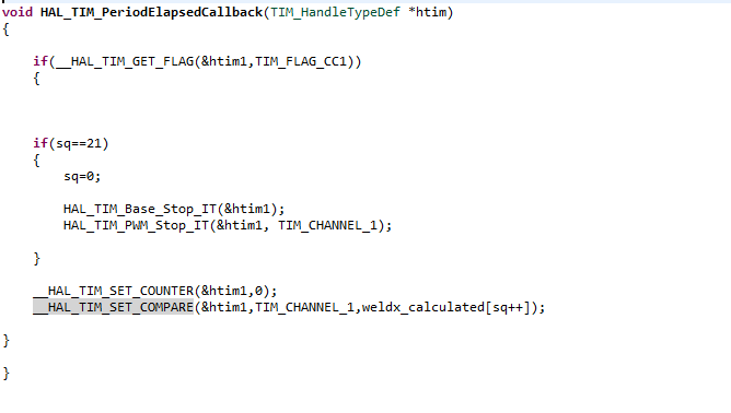

It seems that the logic given below isn't working for Update Interrupt Flag:
void HAL_TIM_PeriodElapsedCallback(TIM_HandleTypeDef *htim)
	if((htim->Instance->SR &  TIM_FLAG_UPDATE  ) ==  TIM_FLAG_UPDATE )
		__NOP();
		HAL_GPIO_WritePin(GPIOA,Weld_Pin,GPIO_PIN_SET);
		//__HAL_TIM_CLEAR_FLAG(&htim1,TIM_FLAG_UPDATE);
		//__HAL_TIM_CLEAR_IT(&htim1,TIM_FLAG_UPDATE);
	if((htim->Instance->SR & TIM_FLAG_CC1  ) == TIM_EVENTSOURCE_CC1)
	//	HAL_GPIO_WritePin(GPIOA,Weld_Pin,GPIO_PIN_RESET);
	if(sq==22)
		sq=0;
		HAL_TIM_Base_Stop_IT(&htim1);
		HAL_TIM_PWM_Stop_IT(&htim1, TIM_CHANNEL_1);
		Flag = false;
	if(Flag)
		__HAL_TIM_SET_COUNTER(&htim1,0);
		__HAL_TIM_SET_COMPARE(&htim1,TIM_CHANNEL_1,weldx_calculated[sq++]);
Could this be because in the Interrupt Handler IRQ This is already reset in software ,after that the PeriodElaspedCallback is executed, I'm leaving the code snippet below where they reset Update Interrupt Flag :

HAL_TIM_PeriodElapsedCallback() is specifically for Update interrupts. CC interrupts have some other callback; I don't use Cube/HAL so I don't care.
I also recommend not to use Cube/HAL if you want to achieve any reasonable timing/precision.
