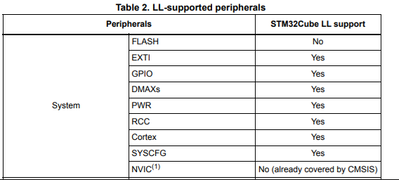

But after deep check on the Cube firmware side, there is NO ll_flash drivers, so you should migrate manually to HAL drivers.
The tool only provides a set of macros and functions that are related to FLASH and are already declared on the ll_system.h side.

I noticed that LL_FLASH does not exist, so I relied on SPL2LL-Converter to "somehow" convert it...
Will there ever be LL_FLASH?
PS: I don't have anything in FLASH on HAL...
