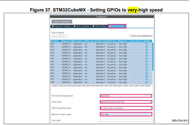

KDJEM.1
Hello @andgarriv,
Please make sure that all GPIOs configured to very-high speed.
Which Refresh rate are you using?
Thank you.
Kaouthar

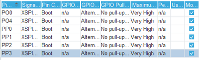

Hi Kaouthar,
The GPIOs are already configured to Very High speed by default. As for the refresh rate, I have tried several values. Currently, the XSPI clock is running at 50 MHz with a prescaler of 1 (so the PSRAM sees 25 MHz), and I am using a refresh value of 200.
Thanks,
