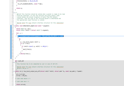

So after reading through that KB article you linked, I decided to start again from scratch. I saved my user code in visual studio for later once I can get the ethernet actually up and running. I therefore created a new CubeIDE project and followed along exactly with the article. I then added breakpoints and a GPIO toggle just before the osKernalStart and after. Unfortunately, my code still does not leave the osKernalStart. However, this time it is getting stuck in a different place, specifically memp.c. I will provide a screenshot of the location and code:
/* create a linked list of memp elements */
for (i = 0; i < desc->num; ++i) {
memp->next = *desc->tab;
*desc->tab = memp;
#if MEMP_OVERFLOW_CHECK
memp_overflow_init_element(memp, desc);
#endif /* MEMP_OVERFLOW_CHECK */
/* cast through void* to get rid of alignment warnings */
memp = (struct memp *)(void *)((u8_t *)memp + MEMP_SIZE + desc->size
+ MEM_SANITY_REGION_AFTER_ALIGNED
#endif
#if MEMP_STATS
desc->stats->avail = desc->num;
#endif /* MEMP_STATS */
#endif /* !MEMP_MEM_MALLOC */
#if MEMP_STATS && (defined(LWIP_DEBUG) || LWIP_STATS_DISPLAY)
desc->stats->name = desc->desc;
#endif /* MEMP_STATS && (defined(LWIP_DEBUG) || LWIP_STATS_DISPLAY) */
* Initializes lwIP built-in pools.
* Related functions: memp_malloc, memp_free
* Carves out memp_memory into linked lists for each pool-type.
void
memp_init(void)
u16_t i;
/* for every pool: */
for (i = 0; i < LWIP_ARRAYSIZE(memp_pools); i++) {
memp_init_pool(memp_pools[i]);
#if LWIP_STATS && MEMP_STATS
lwip_stats.memp[i] = memp_pools[i]->stats;
#endif
If you were to open memp.c, this would be lines 193-235. I am almost positive I followed the article to a T.
I appreciate the help!

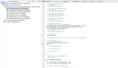

I realize I should have specified, it creates an endless loop and never leaves!
I will also include this, so if I press F8 once the osKernalStart() breakpoint is reach, this is what comes up in the debug perspective/stack:
STackPointer64
Hello @kyleg4032,
You are currently working in a Real-Time Operating System (RTOS) environment, which operates differently from a traditional bare-metal or non-RTOS environment. In an RTOS, tasks are managed and scheduled by the operating system, ensuring that each task gets the CPU time it needs based on priority and timing requirements. This means you cannot rely on traditional infinite while loops to handle your application's logic, as this would block the CPU and prevent other tasks from running.
Instead, you should create a thread (or task) in the RTOS in STM32CubeMX, to define your application's behavior. Each thread runs independently and cooperatively with other threads, allowing the RTOS to manage task scheduling efficiently. This approach ensures that your application remains responsive and adheres to real-time constraints.
Thread creation and configuration can be done in STM32CubeMX FreeRTOS settings under Tasks and Queues. Leave the default task as it is, and create a new task that will handle the execution of your Modbus program flow.
