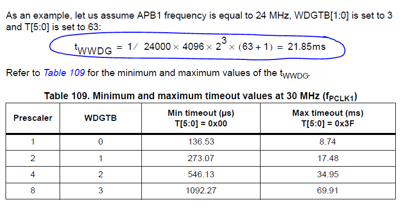

error in the datasheet of stm32f407
Hoang_Tran
1 REPLY 1
Imen.D
Hello @Hoang_Tran​ ,
You are right, I confirm the error in this equation and raised this internally for correction.
Thank you for highlighting this.
Best Regards,
Imen
