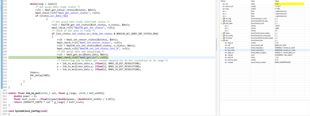

at the moment i try to read correct accelerometer data with a STM32L010C6 Microcontroller from a accelerometer sensor BMA530. The connection is via I^2C (SDA and SCL) and i programm the Microcontroller with a ST-LINK V2. I took a code from gitHub Platform boschsensortec/BMA530_SensorAPI and changed it because in the common.c data i can´t use the coines commands because the STM32L010C6 needs STM32 HAL-Functions because Bosch use other Hardware as STMicroelectronics.
The dev_addr2 = (0x18 << 1) see at https://sourcevu.sysprogs.com/stm32/HAL/symbols/HAL_I2C_Mem_Read#:~:text=SourceVu%20STM32%20Libraries%20and%20Samples,information%20for%20the%20specified%20I2C
and i got it from the BMA530 Datasheet - The default 7 bits I^2C address is 0x18.
The Mem_addr = 0x18, i got it from the BMA530 Datasheet. 0x18->ACC_DATA_0 -> Read-only acc_x_7_0.

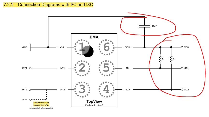

 In the BMA530 Datasheet at the Connection Diagram there are two resistors which i don´t have at my board. Could the resistors be the troublemaker?
I´m thankful for any help!
Best regards

I2C always needs pull-up resistors. For slow speeds maybe the MCU's internal resistors might be good enough, but you must activate these when setting up the I2C GPIOs.
Next step: get an oscilloscope and check what's happening on the SDA & SCL lines.
Further, check if the 0x18 address actually must be shifted or not, meaning that usually the device datasheets give the actual address, and you must not shift that one when writing the slave address register bits.

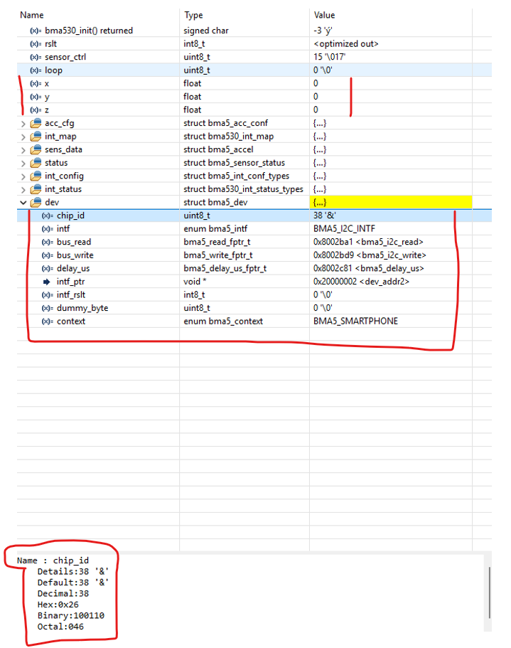

The I2C Speed Frequenzy is 100kHz and the I2C Speed Mode is in Standard Mode. I changed the GPIO Pull-up/Pull-down to Pull-up in the STM32CubeMX and generate the code. I don´t have a Oscilloscope for testing here and it´s impossible to connect the wire because the componets are placed on a thin flex PCB.

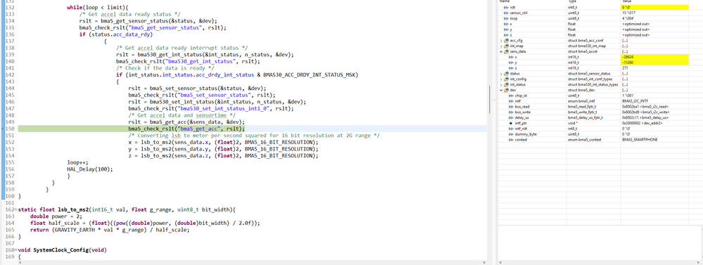

I try 2 tests in the debugg session. The first with the dev_addr2 = (0x18 << 1) and Mem_addr = 0x19.
The sens_data values for x and y changed for every loop and the value for z doesn´t changed, the sensor is layed flat on the surface so normaly the value should be for sens_data_z -16350 lsb which is -9.81m/s^2.
The question is, are the sens_data_values random and not true and are they influenced by the missed resistors?
The second test in the debugg session is with dev_addr2 = 0x18 and Mem_addr = 0x19.
There the sen_data values doesn´t changed for every loop so i think the dev_addr2 = 0x18 is not the correct one.Testdurchlauf_29_04_2026_1.pngTestdurchlauf_29_04_2026_2.png
This will almost certainly not work. The internal pull-ups are too weak, by about an order of magnitude.
The I2C bus basically forms a "wired OR", the pull-ups are essential for the physical level. About 2k...10k should be fine. I would suggest 2.4k .. 4.7k.
It doesn't matter where you place these resistors on the bus. If your MCU sits on a board, perhaps it has connectors where you could add them to.

i bought a breadboard and put the two 4.7kOhm resistors as mention in the bma530 Datasheet between the SDA line and V+ line and SCL Line and V+ Line.
It worked out and i can see the correct accelerometer data.
Thanks a lot for the help.
