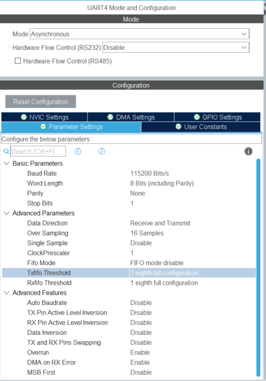

Hi all,
I'm trying to setup a DMA TX UART code using STM32H743VI MCU. The problem I'm facing right now is every time I call HAL_UART_Transmit_DMA function, I get a HAL_DMA_ERROR_TE in my DMA error call-back. The actual line of code is as follows:
char temp[] = "ATI\0";
HAL_UART_Transmit_DMA(&huart2, (uint8_t *) temp, 4U);
Strange thing is when I call this function without the temp buffer it works. For e.g.
HAL_UART_Transmit_DMA(&huart2, "ATI\0", 4U);
I have worked on STM32F4 series as well and I didn't face this type of problem before. The settings for UART and DMA are as follows:
  • DMA mode normal
  • DMA direction Mem-Peripheral
  • DMA priority low
  • DMA data width byte
Any help would be much appreciated. Thanks

Hi, Unfortunately that doesn't work either. I have seen some UART example for STM32H743 cube expansion package and they have CPU cache enable. I've tried that as well but no success at all.
It also works fine without the DMA as well
HAL_UART_Transmit_IT(&huart2, (uint8_t *) temp, 4U);
