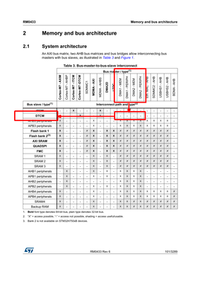

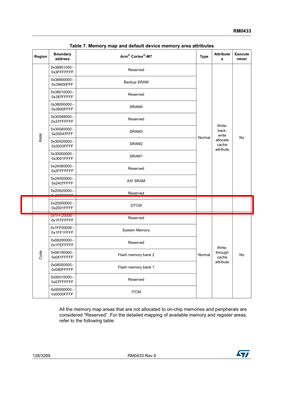

0x20009d84 is in DTCM
In 'H753, there's no route from DMA1/DMA2 to DTCM:

‎2024-07-16 8:30 AM
‎2024-07-16 1:25 PM
Thank you! I didn't even consider it was the memory region that was the problem. Creating the buffer on the HEAP resolved the issue.
