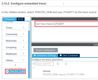

‎2024-07-09 2:14 AM - edited ‎2024-07-09 2:14 AM
It's because you need to add a part in the firmware.
Have you followed the above link I shared ?
You need to configure a LPUART and an utility : Tracer_emb as on below picture.

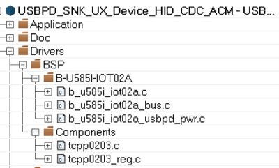

@Nicolas P. I'm following the manual as I write to you and will update in a new comment once I'm done with It,
But before that, I must say that the USBPD_SNK_UX_Device_HID_CDC_ACM example doesn't include TCPP support.
Will it even work without it?

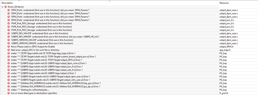

‎2024-07-09 3:01 AM
@Nicolas P.
I get these errors after generating the code
‎2024-07-11 7:38 AM
Hello @ElectroManiac
The example USBPD_SNK_UX_Device_HID_CDC_ACM uses the TCPP.
Can you share your .ioc please ?
You made another post here. Is it the same project / issue ?
