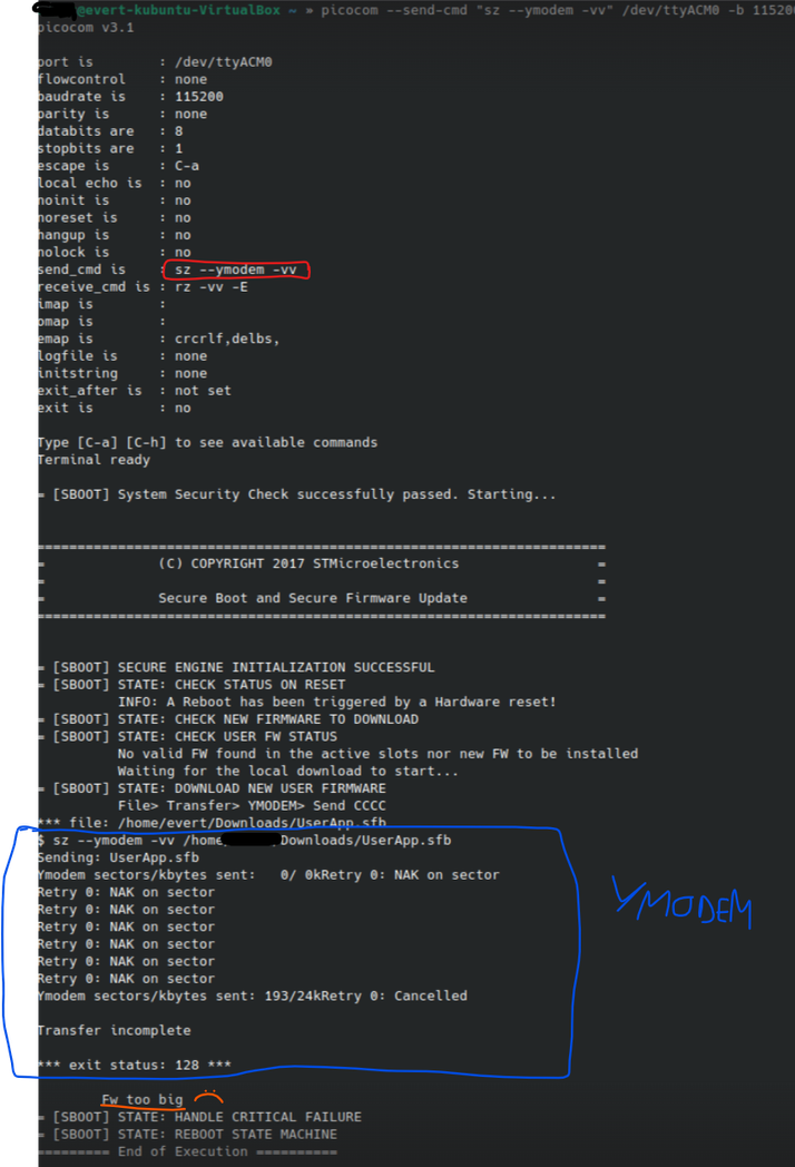

After succesfull compiling (NUCLEO-G474RE) SBSFU and uploading UserApp troguh (TERATERM)
\en.x-cube-sbsfu-v2-7-0\STM32CubeExpansion_SBSFU_V2.7.0\Projects\NUCLEO-G474RE\Applications\2_Images
I decided time to do the same in linux, the issue is teraterm doesnt work for linux.
Trying to use minicom:

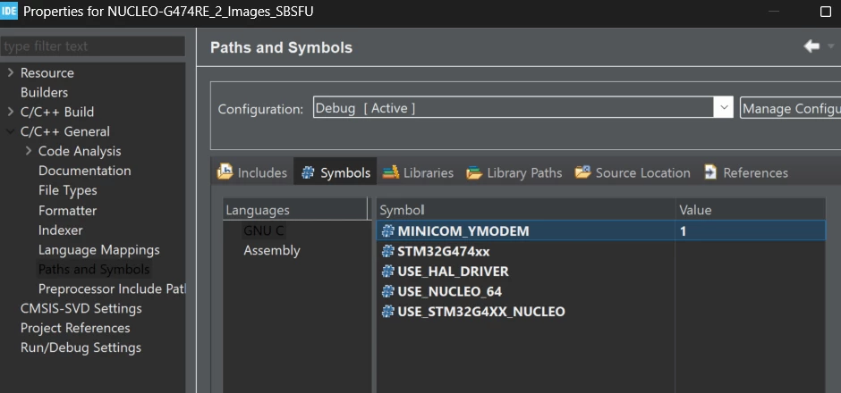

Adding the simbol for minicom special compilation and recompiling SBSFU

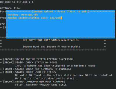

minicom uses by default YMODEM lrzsz implementation
The FW update is VERY SLOW (for only 24K) and ends up with incomplete
half update:

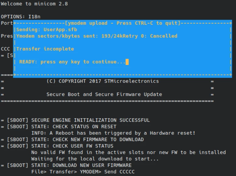

full update, it says incomplete:
and the SBSFU console says FW too big

 File> Transfer> YMODEM> Send CCCCC
 Fw too big

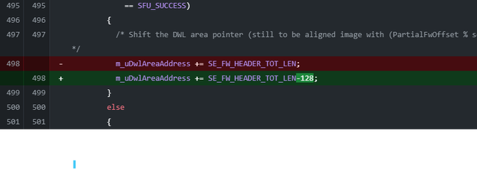

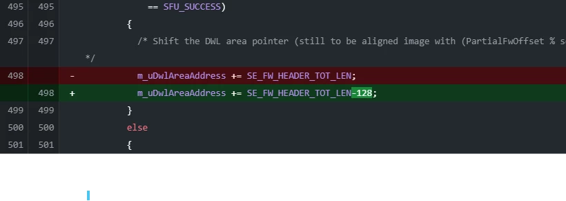

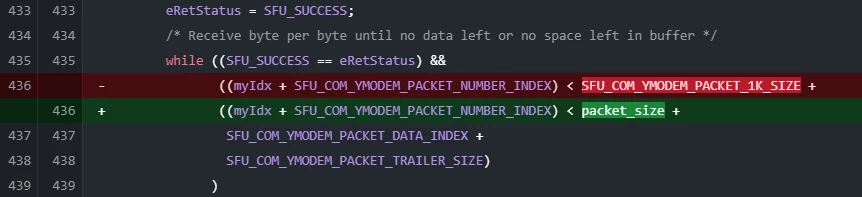

Alright after two full days of untangling spaggeti.
The magic changes that make the SBSFU 2.7.0 , u FW update work with minicom  are: (only 128 bytes packet size)
To fix YMODEM transmission:
To fix the padding bytes mess from the FW update (128==SFU_COM_YMODEM_PACKET_SIZE)
If ST had this code in a public git repo i would create a bugfix report, but they dont .... :D , and they labeled the code as legacy and not supported.... release it to the community, come oon!

result: are those garbage ACK errors?
Sending: UserApp.sfb
Ymodem sectors/kbytes sent: 1/ 0kRetry 0: NAK on sector
Retry 0: Got 49 for sector ACK
Retry 0: Got 41 for sector ACK
Retry 0: Got 4e for sector ACK
Retry 0: Got 68 for sector ACK
Retry 0: Got 4f for sector ACK
Retry 0: Got 55 for sector ACK
Retry 0: Got 53 for sector ACK
Retry 0: Got 48 for sector ACK
Retry 0: Retry Count Exceeded
Transfer incomplete

Im cornering the "FW too big" problem to this line inside SFU_COM_YMODEM_DataPktRxCpltCallback()
 /* Check size to avoid writing beyond DWL image size */
 if ((m_uDwlAreaAddress + rx_size) > (m_uDwlAreaStart + m_uDwlImgSize))
 m_LoaderStatus = SFU_LOADER_ERR_FW_LENGTH;
 e_ret_status = SFU_ERROR;
m_uDwlAreaAddress = always 0x8048000
m_uDwlAreaStart = changes ?
rx_size is always 128
m_uDwlImgSize = received image size by YMODE block 0 info,  (in my case 24704)
i believe the last packet being received is not expected?
hit me up in https://www.linkedin.com/in/javiermuñoz/

Javier1
Javier1AuthorBest answer
Principal
May 29, 2025 10:14 AM UTC
Kudos a @Pavel A. for the support
