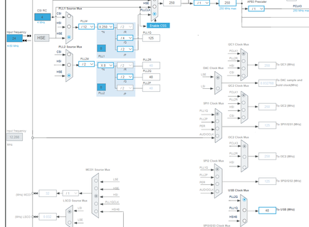

I am using STM32CubeMX 6.16.1 with a STM32H503RB and I have exactly the same problem :
RCC is configured with LL library (not HAL), here is the SystemClock_Config() function generated by STM32CubeMX :

PLL2 is never init although PLL2Q is selected in USB Clock Mux.

KevinW
Hi @FBL
Please find the .ioc in attached file.
Also, I configured USB in device mode with default pins (PA11/PA12). Both pins aren't set up, I had to configure them manually (I don't use ST USB Stack but tinyUSB because I need USBTMC class that isn't provided with ST USB stack).

Hi @KevinW
Did you check HAL_PCD_MspInit() inside stm32h5xx_hal_msp.c?
On my side, CubeMX generated it as follows:
void HAL_PCD_MspInit(PCD_HandleTypeDef* hpcd)
  if(hpcd->Instance==USB_DRD_FS)
    /* USER CODE BEGIN USB_DRD_FS_MspInit 0 */
    /* USER CODE END USB_DRD_FS_MspInit 0 */
    LL_RCC_SetUSBClockSource(LL_RCC_USB_CLKSOURCE_PLL2Q);
