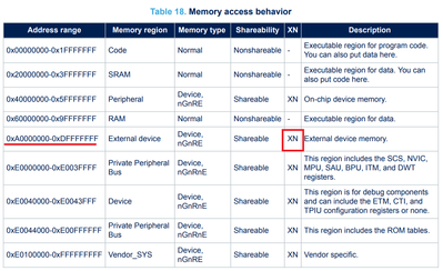

For scatter loading, your process seems to be correct. SDRAM and its respective GPIOs need to be initialized before main(), i.e. in SystemInit(). Unfortunately there is no example available on STM32H5 for this scenario but STM32H743, has such implementation in the HAL, especially in system_stm32h7xx.c
You need to look at blocks where DATA_IN_ExtSDRAM is defined.

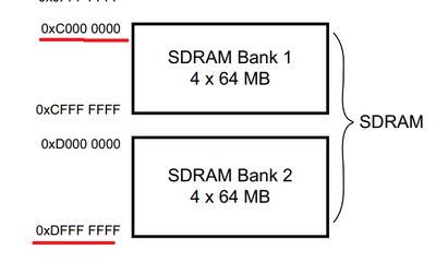

Meanwhile, the SDRAM region in STM32H5 is in the range of 0xC000 0000 to 0xDFFF FFFF, according the reference manual RM0481
While, by default, the region is in execute never configuration (XN), according to the programming manual PM0264:
So most probably that's why you are facing a hard fault while executing from SDRAM. You should configure that region to make it executable using the MPU before jumping to the main.
Hope that helps.

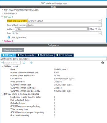

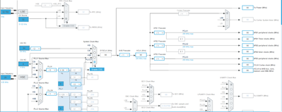

shashank78Khandve
HI @mƎALLEm ,
I forget to tell the clock configuration i did for this setup, it is as per the below
also i an running the SDRAM on the 45 Mhz and did the confuguration as per below in mxcube ide
please let me know if i am doing it in wrong way or anything more required for the analysis..
Regars,
Shashank K.
I've already provided some hints previously and as said I can't really help you in the SDRAM configuration. You need to follow the article I have shared previously.
Meanwhile, you need to disable the eXecute Never (XN) from that region using MPU.
You can inspire from the implementation provided in the X-CUBE-PERF-H7 cube package especially the configuration 10 - D1_SDRAM_Swapped - D1_DTCM : execution from SDRAM and data on DTCM RAM.
The target is STM32H7 but the principle is the same.
