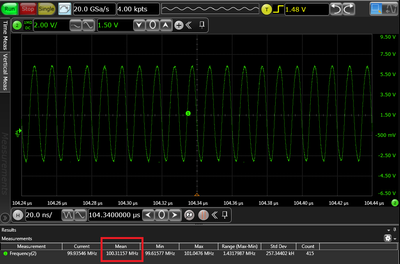

Hello @Ronil ,
I kindly requested an internal colleague to do the test on a Nucleo H753 with KEYSIGHT DSO9254A oscilloscope. 100MHz is output on the MCO pin like shown in this oscillo screenshot:
So you need to use an adequate oscilloscope and probes for these high frequencies.

‎2024-08-22 5:33 AM - edited ‎2024-08-22 5:53 AM
thank you so much, I use PiScope which operates until 500 Mhz, can you watch my script I expect receive 96 Mhz, but is nothing
/* USER CODE BEGIN Header */
* @file : main.c

‎2024-08-22 6:05 AM
Probably I solved the problem! thank you all!
