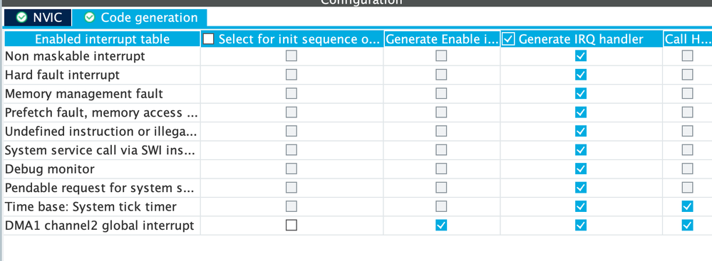

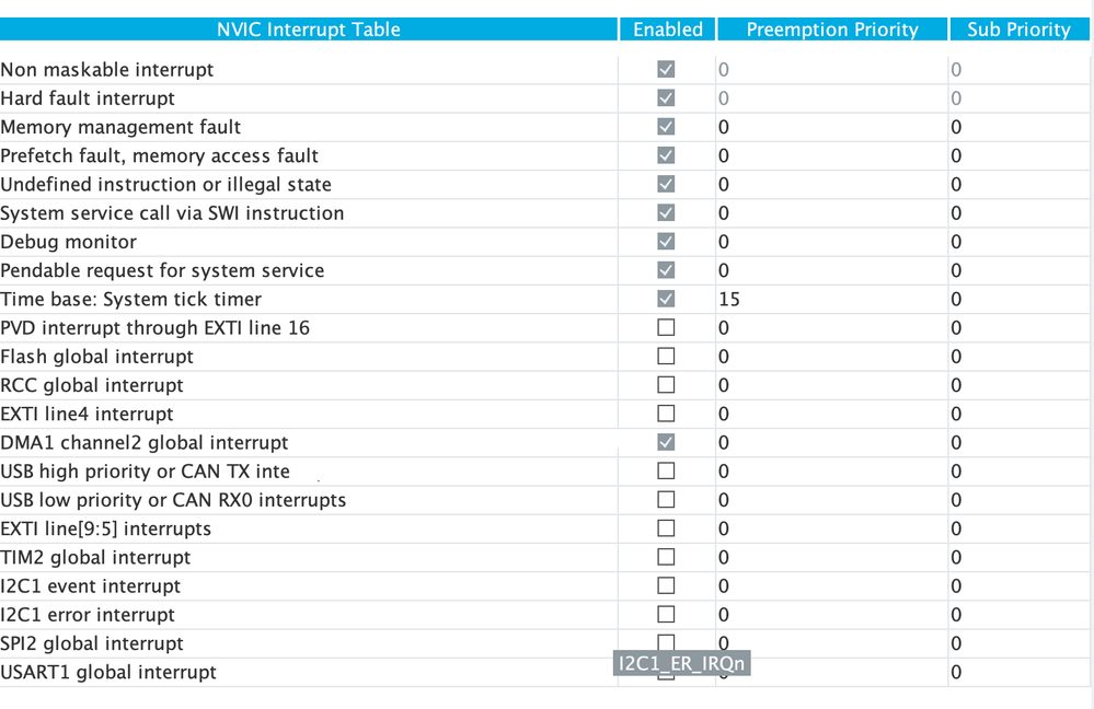

This is the view NVIC in CubeMX,
Does it change something to uncheck these ?

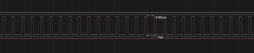

Putting DMA in motion, I have better accuracy but stil some glitch... this is crazy... really really crazy
I do not understand...
V
vbesson
Senior
Frame should all be 1us High and 3us low, and I still have glitches...
I don't see any glitches in your screenshot.
Timing also looks good. The imperfections be an issue with synchronization between the logic analyzer and the microcontroller. Try a logic analyzer with a higher clock and you might see even better timing. Clock dither of the MCU and/or the logic analyzer can also be a factor. Rise time can also be a factor in imperfect measuring of pulse widths.
You say your logic analyzer is clocked at 24MHz, but that would make 3.063us about 73.512 clock cycles of your logic analyzer (or exactly 73.5 cycles and the 3.063 is a rounded number). So that cannot be correct. Does it sample at both edges of the clock? So 48 MSamples/second?
Kudo posts if you have the same problem and kudo replies if the solution works.
Click "Accept as Solution" if a reply solved your problem. If no solution was posted please answer with your own.
I have done sampling at different logic analyser speed rate and the pulse timing is not right. I have a comparison with an ATMEGA328P.
The issue is that I have 402 bytes per data stream to be sent, it means 402*8*4 us period = 12 864 us for a data sector.
When I have 0.063 us shift time to time, I can have more than 1 bit or 2 shift in the end and data corruption with the 2 byte XOR CRC send at the end of the transfer.
I found an interesting article, and I am currently testing it Disabling / enabling IRQ on STM32 for atomic read
Will keep you posted
Vincent
