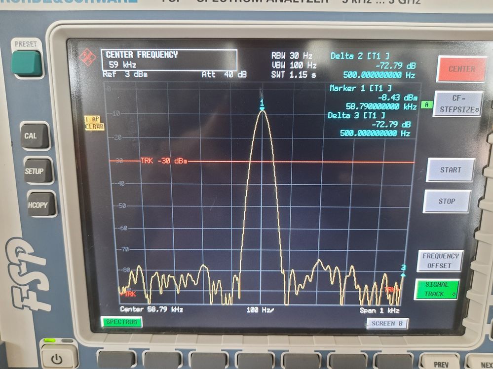

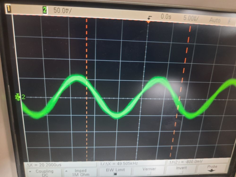

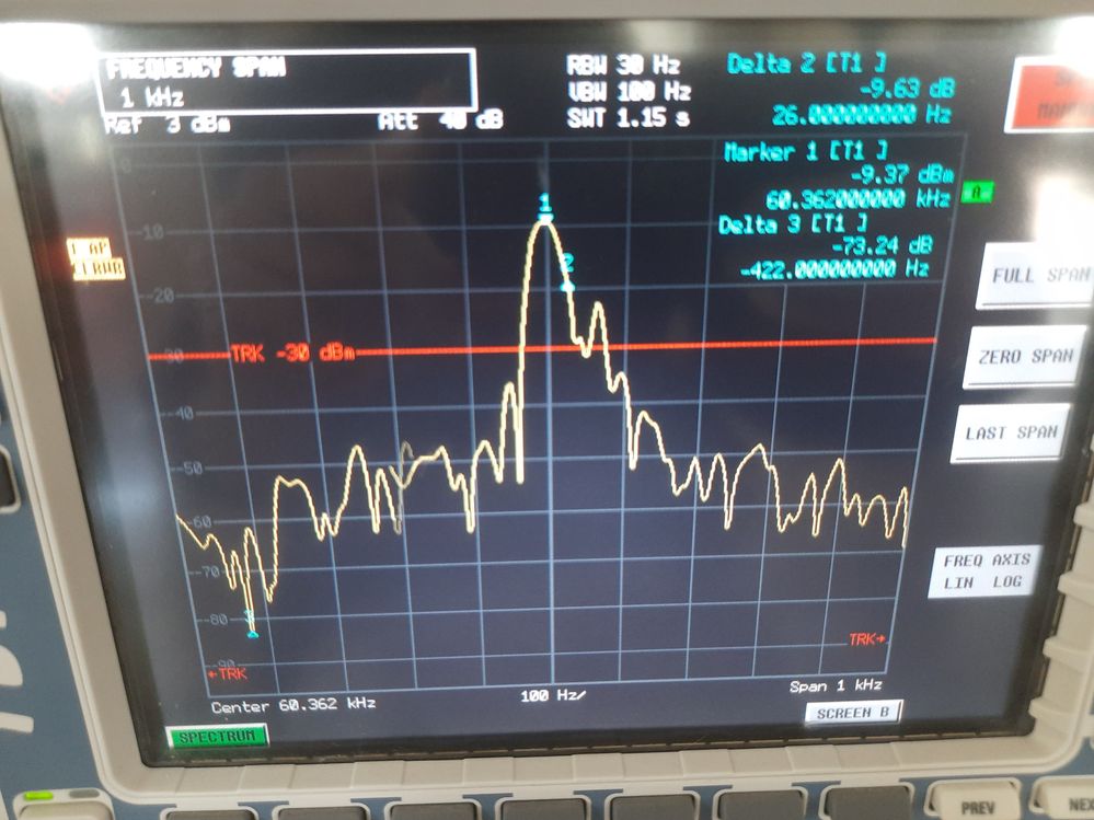

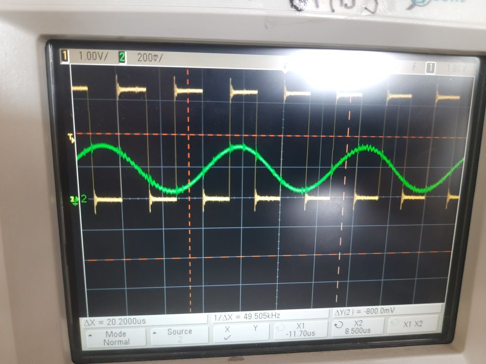

I have implemented a DDS sine wave generator where I use a timer interrupt to update DDS phase word and also use the same timer triggering a SPI transmission via DMA to an external DAC using a nucleo-g431rb. I am now doing the same thing with a nucleoh723zg on a different pcb, but cannot achieve the same performance. I've only uploaded 1 spectrum image of the H7 output but the problem is the image I uploaded is not the constant spectrum, it's center frequency changes -20 to 20 Hz every sweep.
I am using ~16MHz SPI speed and I have checked hardware of both pcbs, there is no problem with the communication and DAC CS jitter is very low (or none) for both MCUs.

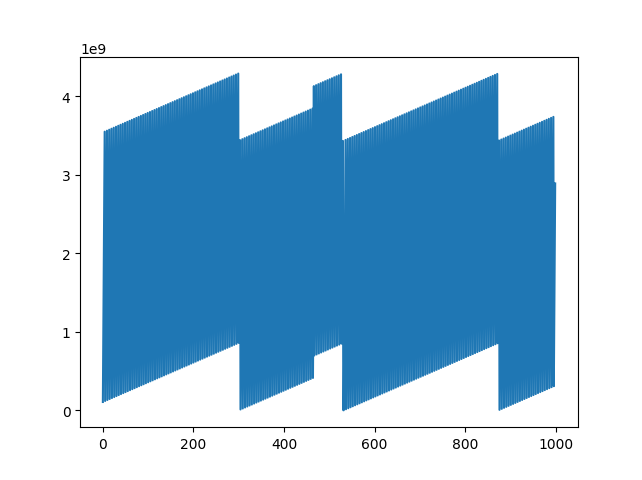

I also checked the phase word variables on the run via uart in H7 and saw that there are reoccurring (not periodic though) jumps in phase word. But I use uart so cannot be exactly sure about that.

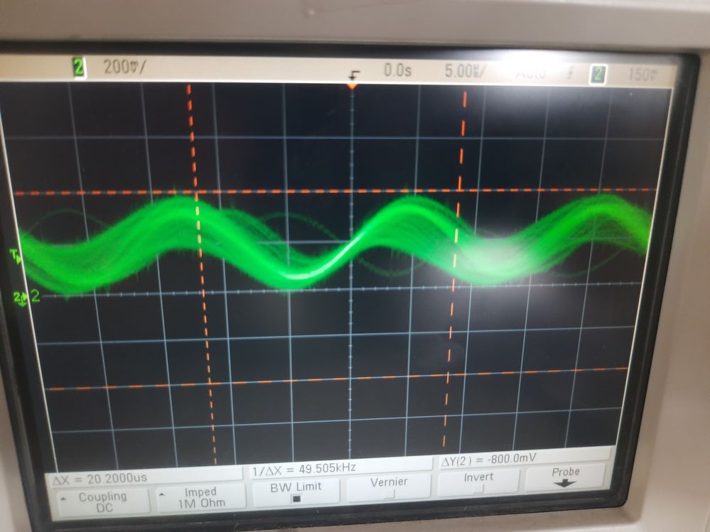

Last time I uploaded code to G4 was ~3 weeks ago, from the images I can see that there is no problem with the uploaded code or LUT in the ROM. However when I disconnect and reconnect H7, before uploading code again the signal in the scope is distorted, probably meaning some ROM corruption occurs when disconnecting or just powering up)

 G4 spectrumG4 spectrumH7 spectrumH7 spectrumH7 scope before uploading new codeH7 scope before uploading new codeG4 scopeG4 scopeH7 scopeH7 scopePhase Accumulator values at every updatePhase Accumulator values at every update

I think there is something wrong with accessing the phase accumulator variable "pa" as the values I read through UART seem to have occasional jumps. The graph I uploaded is from a 1000 continuously filled pa values to dac_test_arr  and almost every 1000 sample block have at least one jump like in the one I uploaded.

Regarding the scope, what I don't understand is that the waveform is corrupted (fig 3) until I upload the exact same code that produces the normal (fig 5) waveform. I have now seen some posts about memory problems even with Dcache disabled and maybe I should manage MPU regions carefully instead of disabling MPU management from CubeMX

I am sure I have no timing problems in hardware as my SPI CS signal shows no jitter in scope, and I remember I was able to get away with a little jitter when developing with G4, though I fixed it later. Also I think you would agree that the signal from the scope doesn't shout noisy spectrum at first glance, I've only noticed it when I tried to sweep a high Q resonator, spectrum analyzer is not my usual debugging tool.
Would you suggest another way to track variables "pa" or "di" other than uart? As I said any continuously filled test section of that buffer shouldn't have any jumps.
