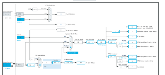

I am porting an old application made on AVR to STM32, and I am facing a strange timing issue.
In a nutshell, the application is reading sector (512 Bytes) from a SDCARD and output the content of the buffer to GPIO with 4us cycle (meaning 3us low, 1 us data signal).
The SDCard read is working fine, and I have written a small assembly code to output GPIO signal with precise MCU cycle counting.
Using DWT on the debugger, it give a very stable and precise counting (288 cycles for a total of 4us).
When using a Logic analyser with 24 MHz freq, I can see shift of signal by 1 or 2 cpu cycles and so delay.
I have tried to use ODR directly and BSRR but with no luck.
Attached :
- Screenshot of the logic analyzer
As you can see I do not have 3us but 3.042 and this is not always the case
Clock configuration

Ok I found it :
It needs to have
void HAL_SPI_TxCpltCallback(SPI_HandleTypeDef *hspi)
  printf("debug full\n");
void HAL_SPI_TxHalfCpltCallback(SPI_HandleTypeDef *hspi){
   printf("debug half\n");
along with
  HAL_SPI_Transmit_DMA(&hspi1,DMA_BIT_BUFFER,1608);               // 402*8*4
By the way the DMA_SPI_TX seems to be the best approach to save RAM and very precise & accurate
