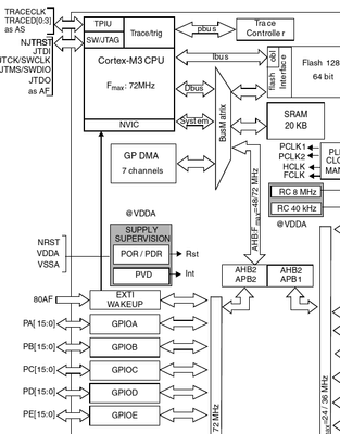

Aaaa, you cannot expect fixed timing, when INT might happen.
Using DMA should be "better" , but still they (dma + cpu) access the same internal bus, so any access might get one or more wait states, until it gets the bus, if there is the bus busy with a transfer at that moment.
You say I am kine to understand why I have a cycle or more shift with assembly code, (maybe I need to disable all interrupts).
Where you have any interrupt happening, it will be many more than one or two cycles. The processor has to save several registers onto the stack, jump to the interrupt-service-routine, do whatever's coded there, then pop those registers off the stack before resuming whatever your code was doing.
I think an approach to improve cycle-accuracy would be have only one clock in the system. Run the processor sufficiently slowly that you don't have any FLASH wait-states (24 MHz?), and have all the AHB, APB1 and APB2 at the same clock-rate as SysClk. That's if you can get all the necessary processing done while running that slowly.
