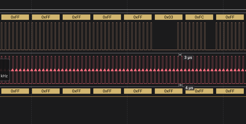

Using DWT on the debugger, it give a very stable and precise counting (288 cycles for a total of 4us).
When using a Logic analyser with 24 MHz freq, I can see shift of signal by 1 or 2 cpu cycles and so delay.
I have tried to use ODR directly and BSRR but with no luck.
Attached :
- Screenshot of the logic analyzer
As you can see I do not have 3us but 3.042 and this is not always the case

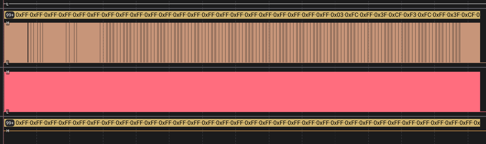

In the end this is the output on the logic Analyser:
