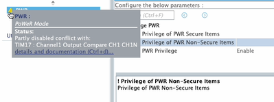

Double check the settings for PWR Mode in the MX configurator (the IOC file).
